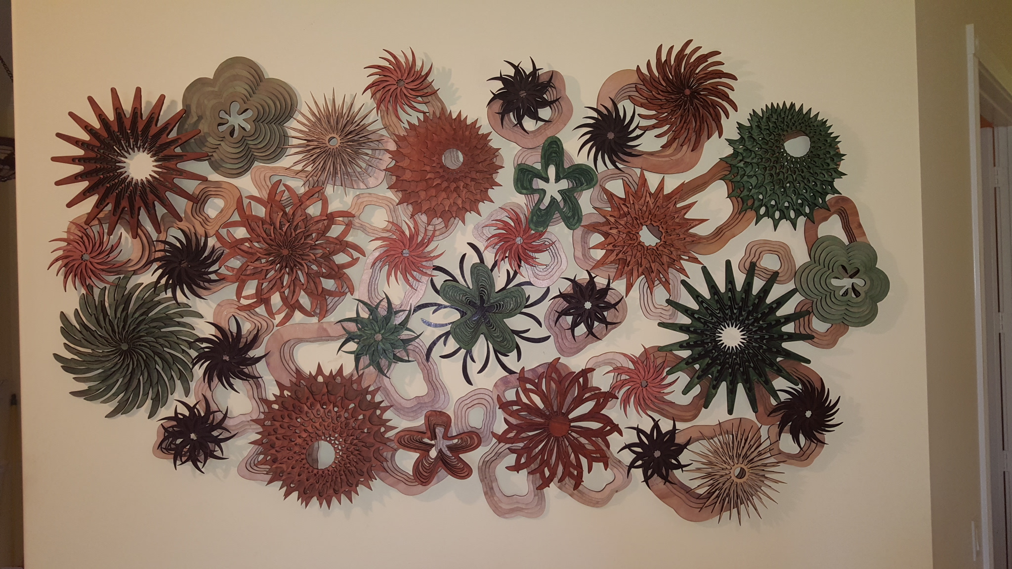

Re: Version 3.01
Thanks to Gearotic, Adobe Illustrator, Cut2D Desktop and my laser cutter,
I was able to build this ocean reef on the feature wall of my living room.
Richard
