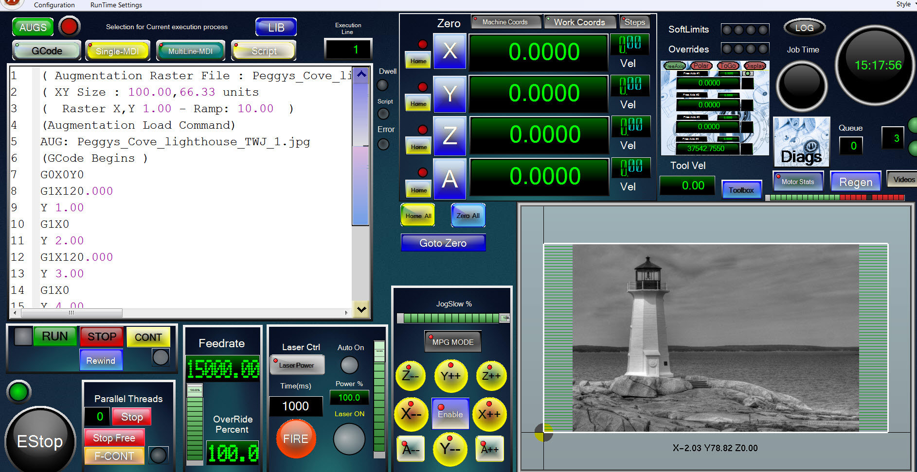

Snapshot of pretesting of Auggie Laser Engraver mode.. :-)

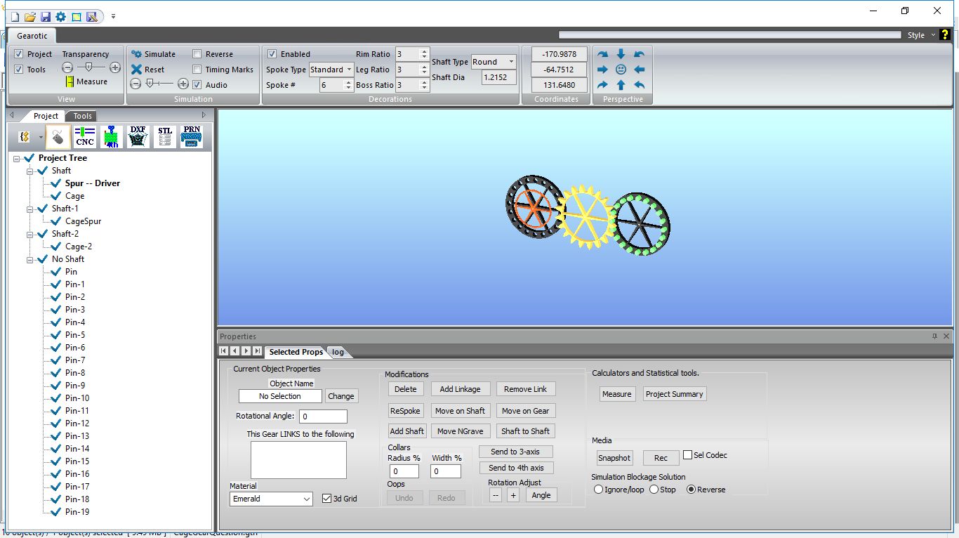

I downloaded & installed the latest version.  I've been trying out the caged gear function and wonder if the behavior captured in the attached CageGearQuestion.gth is normal (I had to zip the .gth file to send it.).  The behavior also existed in the previous release.
When I add a caged gear as the first gear in a new project  all of the pins are created.
When I create a new project with a circular gear and then add a caged gear the gear rim has holes but no pins are created.
When I then add the mating pinion to the pin-less cage gear and then add another cage gear attached to that the pinion the cage gear is created with pins.
Am I misinterpreting how the cage gear function is supposed to act?
Bill
CageGearQuestion.zip
(3.11 MiB) Downloaded 378 times
Re: version 2.3012 online
Hi Bill:
  Nope, that would be a bug. Sorry about that, Ill fix that up tomorrow, a side effect of some recent change I suspect. Looks like the pins are being ignored for some reason..
Thx for the notification..
Hi Bill:
  Fixed for next update. Shouldn't be long.
