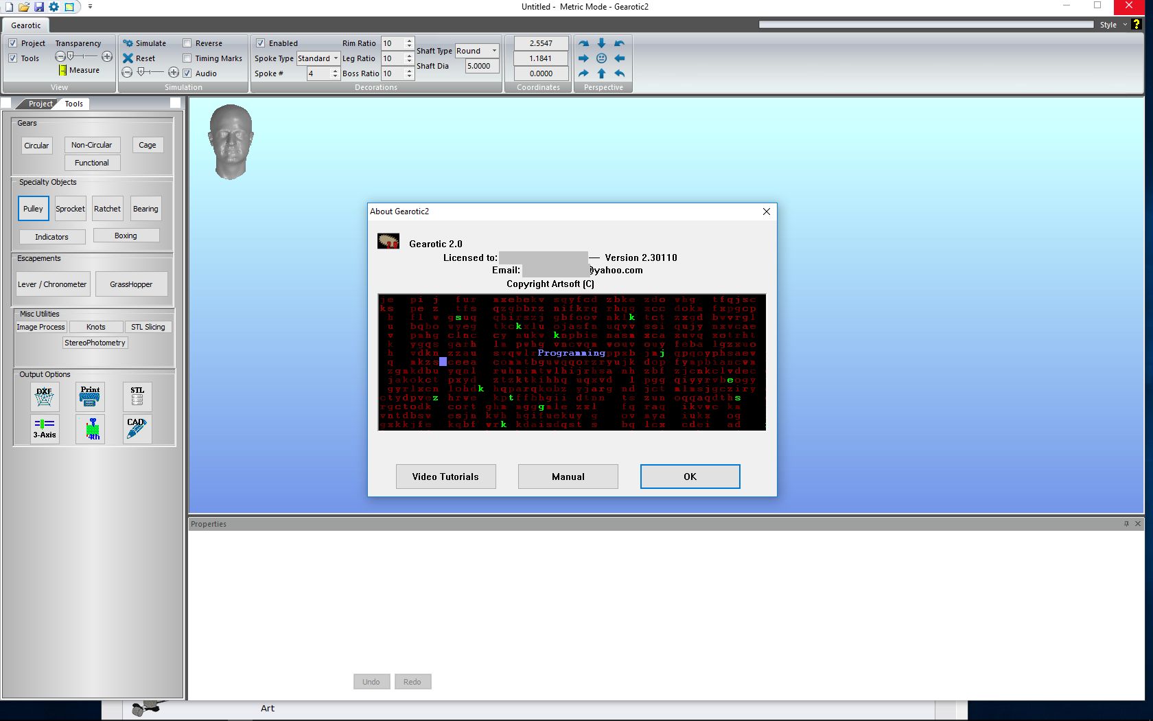

Thanks for steering me to the correct link. The version the "?" screen shows is 2.30110 instead of 2.30011 which I assume is simply a typo in the help screen (see attached image).

Re: version 2.30011 online
Hi Bill:
Yes, thats current. VFW is a bit strange, and has been known to be buggy on some systems. I haven't supported Win10 yet as I haven't tested the various functions. I may look at updating the VFW to some other interface in future
