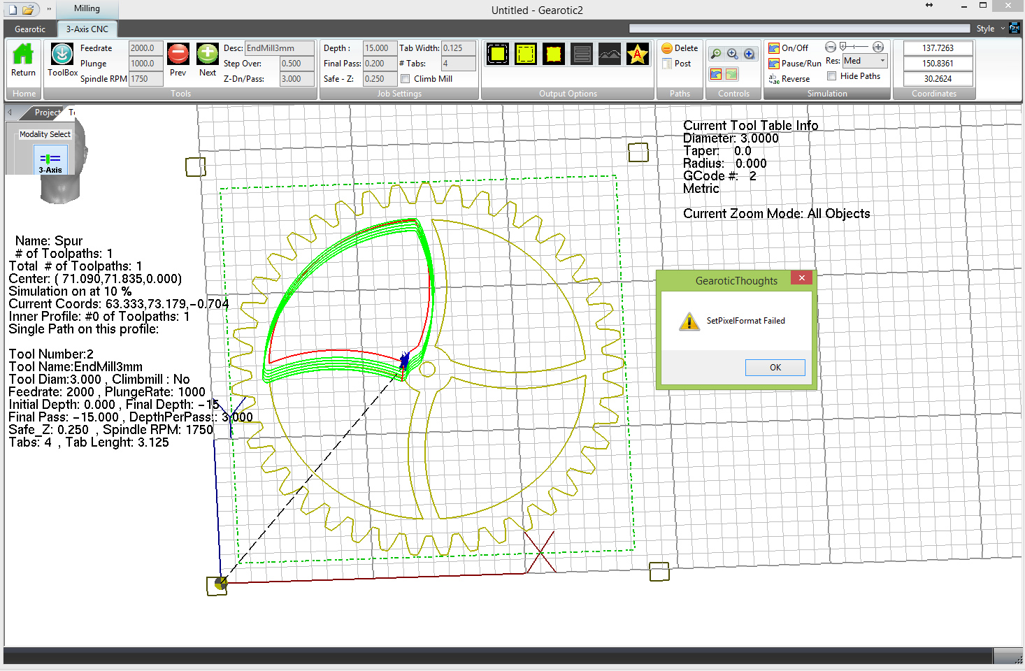

Hello,
Whenever I try to do 3-axis CNC sim, I get "SetPixelFormat Failed" error. Am I doing something incorrectly?
Interestingly enough, 4th axis sim works like a charm.

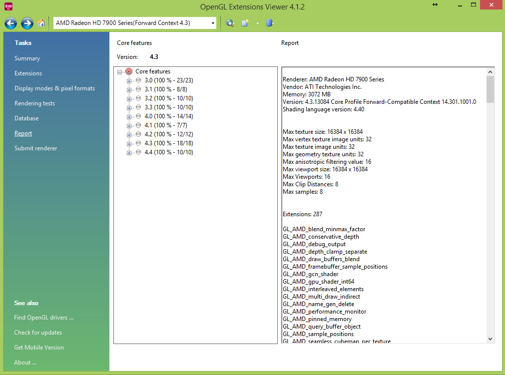

  The simulator can fail on some systems, it required OpenGL version 1.5 with extentions that support VBO's, not all video
cards do, though most recent ones do. Im still looking for errors in it, it is now used in Mach4 as a plugin which has helped me
track down several issues. Im still making changes in it, so each version it should get a bit more stable with various cards, Id
check it each version to see how it works for you.
(Any idea what your OpenGL version is?

Hey,
My OpenGL is 4.3, videocard is Radeon 7950. Not the newest, but still relatively new, 1.5yrs or so.
GLView says it supports 100% of the features. I might see if there are newer drivers available, if you think that might help.

It may.. but Im thinking its probably me. My card is an nvidea, their pretty forgiving about some of the
OpenGL syntax where other cards may fail on a technicallity. Youll probably find the problem goes away
with the next update, if it doesnt.. please let me know and Ill work with you to find the issue by sending you
test version that isolate the issue on your card. ( This helps future users as well..).
Next update should be within a few days, I will bump your sim problem to top of development priority
after that release if your up for a few tests..
  Im pretty sure its simply me using a DC or call that the card doesnt like me calling in that order.. (OpenGL
drivers can be THAT picky... :) )
