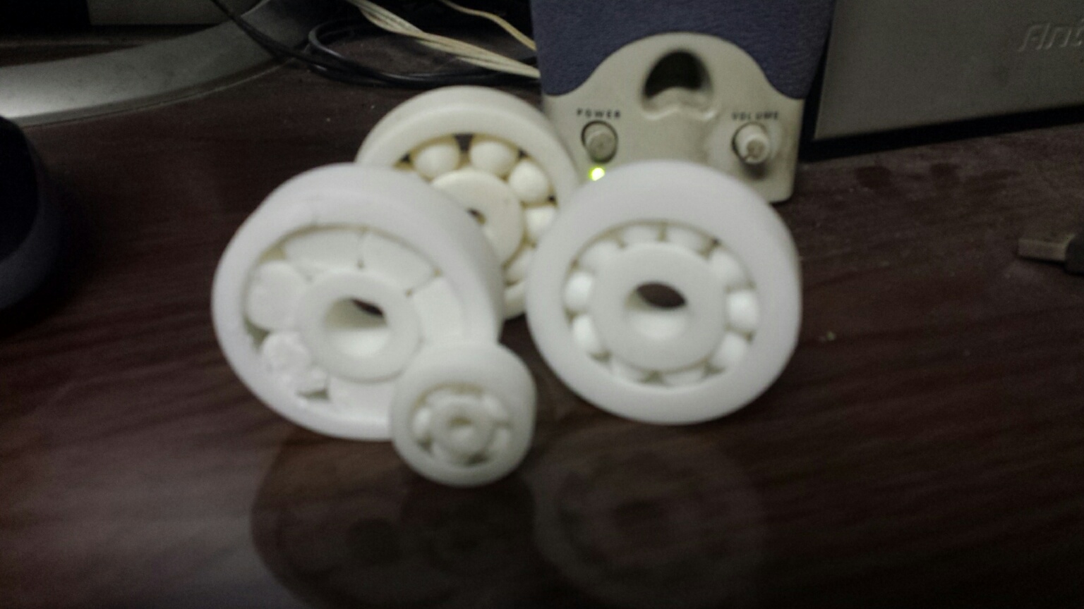

New version to correct a simulation bug with rotation of geneva's.
Also , for 3d printing, Bearings may now be made. ( See Bearing tool button.)
Take note, your 3d printer must be very good to print a working bearing, and near excellent to
use roller bearings. (Photo shows 4 working bearings from my Up! mini printer. ) , the roller
took some time to clean up, the ball bearings worked very quickly with not much cleanup. I suspect a powder printer
would be best for these. :)

they look really nice,
what sort off tolerance gap do you use between parts ?.

Re: New version 1.19
The screen allows you to set a tolerance, but I used .1 on the ball bearings and .3 on the roller bearings.
I made the module because I wanted to be able to make 2-3" OD bearings for wood projects and such that
would have the appearance of home built... Probably useless to most, but hey..it was fun.. . :)
