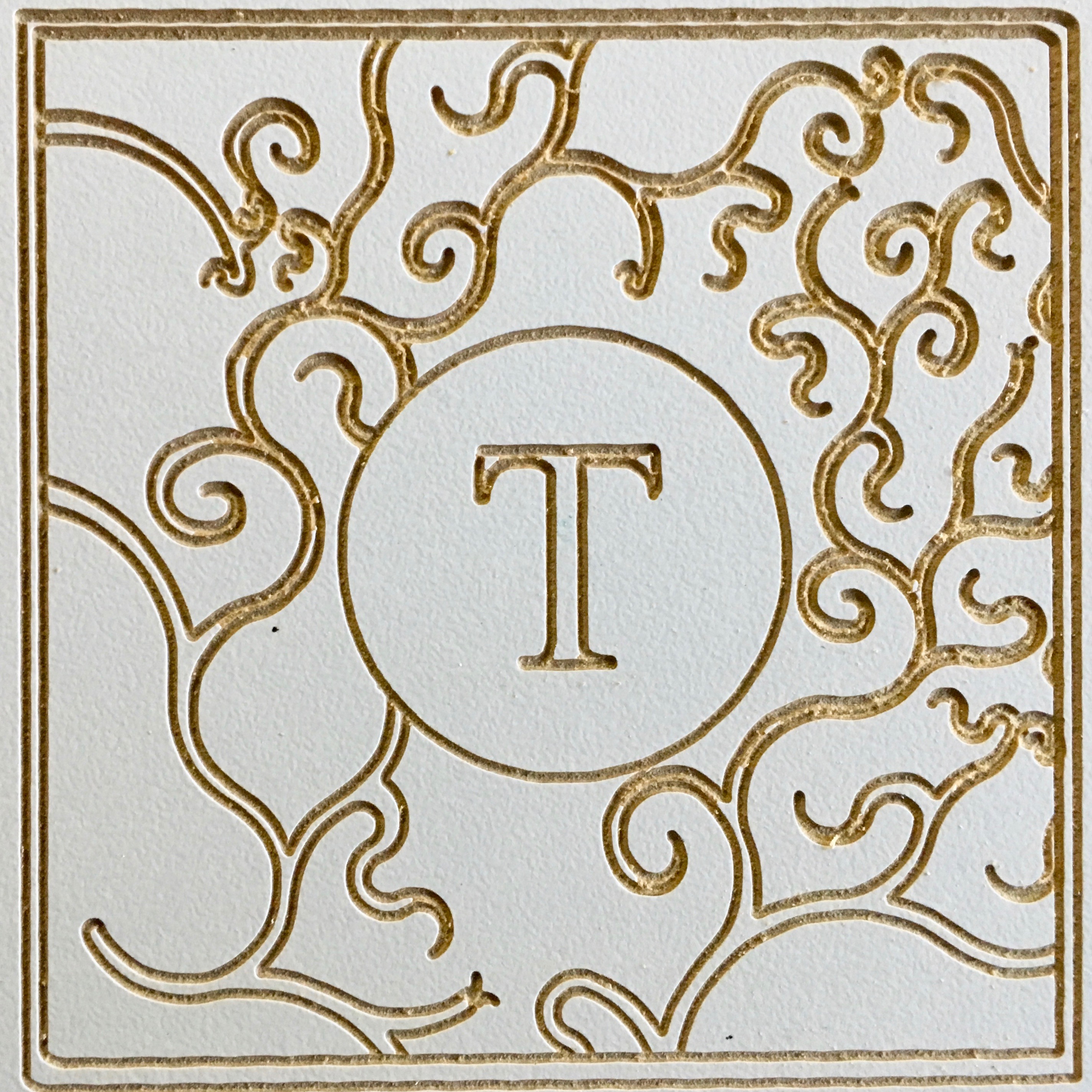

That looks really good..
Im really happy with the receptions vines appear to get, it wasnt something
I was sure people would think worthwhile to be honest..just something I got hooked
on this summer, luckily for me, others seem to like the things that attract my eye. :)

Did you cut and paste the vine to achieve that really nice design? If not how did you do it?
Re: Version 3.01
Hi Dan,
The design was made in Gearotic of course. I then highlighted the whole thing and exported it as a dxf. In the program Aspire (or Vectric works just as well) I imported the dxf of the vine, boxes and letter.
I sized the whole thing down to 3.75 by 3.75 inches and then using the trim function in Aspire removed "stuff" that was outside or inside where I wanted the vine.
The gCode was then produced by Aspire and the actual cut didn't take 15 minutes.
