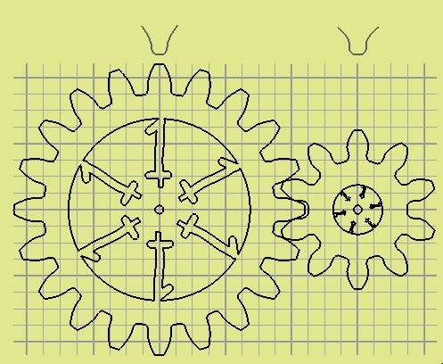

  Spokes are now fixed. One spoke type remains broken, it will be fixed or removed soon, but all others should work fine.

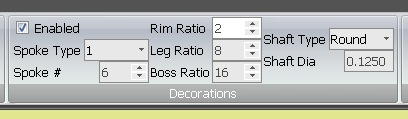

The problem seems to be related to the Leg Ratio.  If the ratio is set to 9 or more then, for me at least, all spokes work.  However, if I set the leg ratio to 8 then there is a problem.
I should say that I don't anticipate using a leg ratio of less than 9 but it does appear to be a limitation..
Re: New version 1.15 of GT.
Ahh yes, I see that now, the fancy spokes get too short so they never reach the boss.. Thx..on my list..
