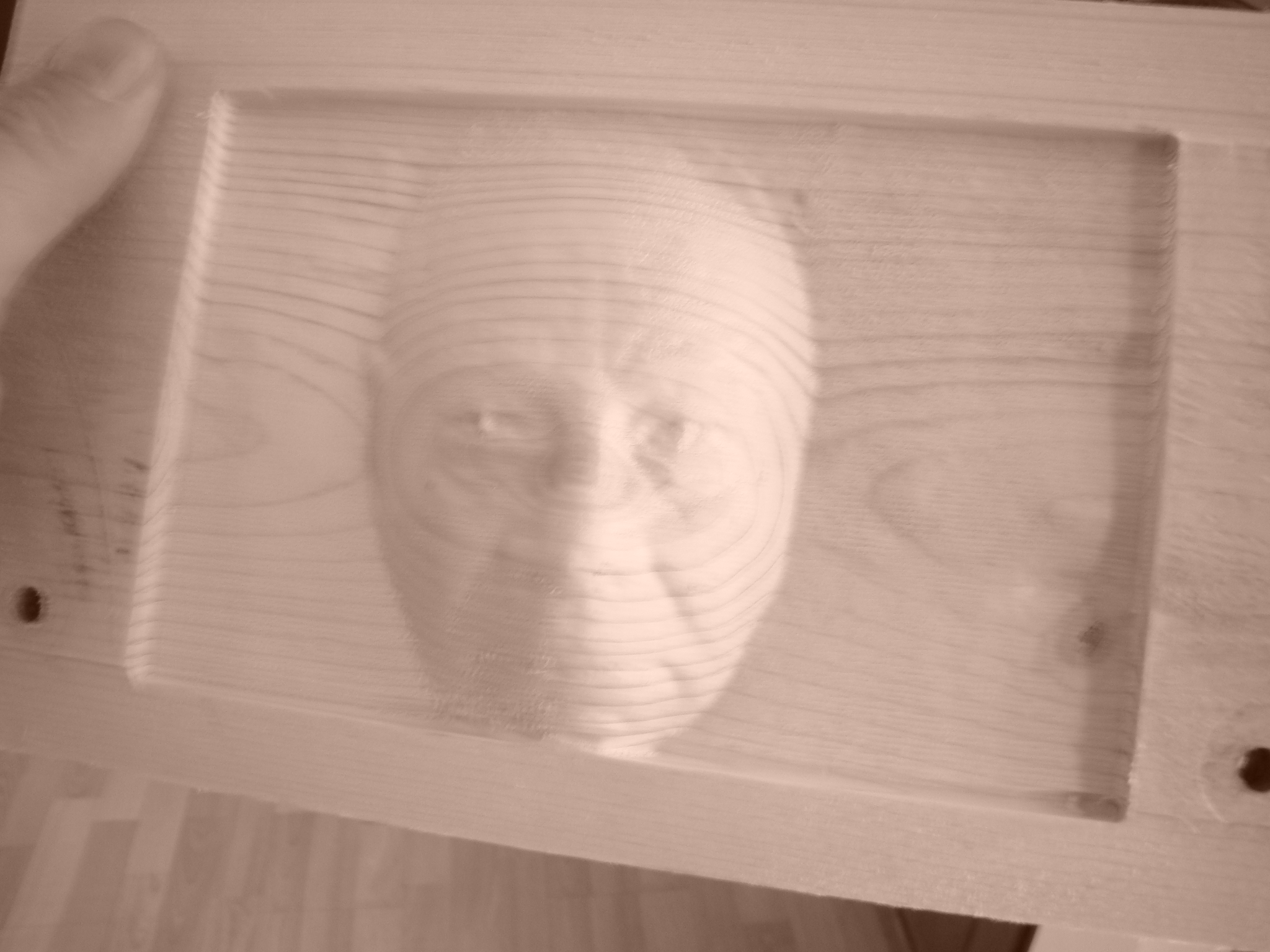

OK. I'm pretty proud of this one finished with a 1/8 " ball.&nbsp; It is sooooo Cool!
Karl
Re: Version 2.298 online.
Karl:
Congrats, that looks excellent. My workshop is only now getting ready so I can cut my own.
You guys are all beating me to the punch.. I gotta learn to hold code back till I get to cut. :)
Seriously , great work..
