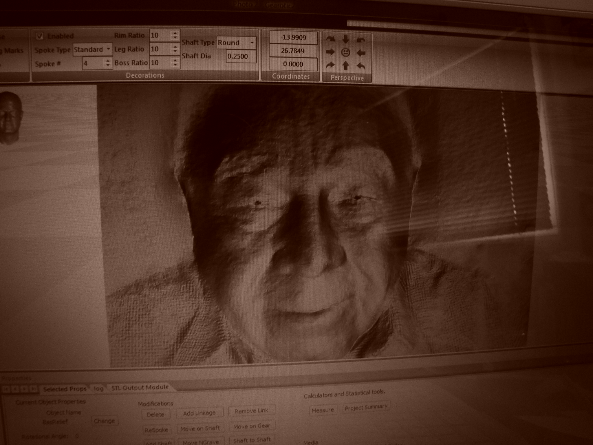

Here is output #2 confidence Value 54.548 I am going to try and 3d print it.
