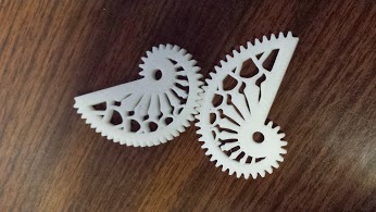

Funny Gears..
  Thought this gear looked funny enough to show.. :)
Re: New version GT version updated to 1.14
Looks funny Truly
The spokes look weak at the hub connection, looks like they would flex and/or break depending on the material used and the direction of rotation. Do like your creative design nature. You are using both Left brain Right brain.  :)
lol.. yes, Im sure making it woudl be a bitch..
Really Im just testing the new spoking calculator for ellipticals.
Shouldnt be too long before this module is ready for the puppies . :)

Very nice;
what machine are they printed on ?
Printed on my Up! Mini, they are module 2, about 2" long in the longest dimension. Took about 30 minutes to print each
one. (And they meshed perfectly first try. ). :)
  A new version with ellipticals and these logarithmic spirals should be out in a day or two I Hope.
