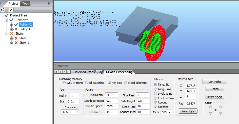

Thanks, good timing I have some large XL pulleys to cut. But have a couple of issues.
Noticed the time and path display does not get reset, every time I hit gen paths it keeps adding to the values
Need a way to control the speed of the message displayed way too fast, I guess I don't read that well, lol
could be if i ran this on a larger monitor it would be easier to read, but this laptop makes the text hard to read.
And maybe I missed this somewhere:
1:/How do I control climb and conventional directions of cuts on 4th axis fly cuts?
2:/How do I control the part Z0 on the center of the pulley?
If I use a slitting type saw I want to be on center line on Z 0 Y radius plus cutter radius and clearance
If I use a profile end mill I need to be on Y 0. Z radius plus clearance
Clip of output for the 3" fly cutter

Re: New version 4.90.03 -- 4th axis
Thx, on my bug list, probably be fixed today or tomorrow..
Also on my list, be fixed same time.
>>1:/How do I control climb and conventional direction s of cuts on 4th axis fly cuts?
You cant at the moment, it cuts back and forth, lowering each time. I will be adding options for various
things such as cutting in only one direction, but in this preliminary release, only the basic option of dual direction
cutting is implemented.
>>if I use a slitting type saw I want to be on center line on Z 0
No matter which ( saw or bit), you zero at the spot shown on the screen. Zero all axis. The program will put out code appropriate for the saw, or flute, tangental
or fly positioning. It will take care of the conversion for all axis configurations as well, but at the moment you cannot swap sides for the saw, it always assumes the
position on the zero degree point, the saw cannot be at 180 degrees on the blank. ( luckily this matches the majority of configurations, but will appear as an option
eventually. ).
This module is pretty preliminary , but will be developed slowly in conjunction with the other modules as they require extra power. Its being released now as I think
people need a way to cut the gears in 4th axis which has the ability to show graphically whats going to happen, GM's limitation in that regard bothered me quite a bit
as it required faith in the path, I prefer some verification graphic so your on the same page as I am. :)

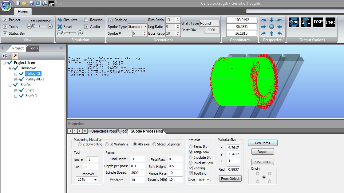

I assume the rapids are in mm per minute?
the other issue is I dont see what you show in your video. watched the movie after I last posted, learned a few things should have watched it before I posted. Sorry
No 4th axis, no cutters, no real definitive paths.
think because my default is in inches it could be why I am seeing screen issues. Or it could be this laptop. Might try installing on a workstation to see if thats it.
Regen works for the times but the Gen paths still add the times.
thanks for the added message timer option.
note: it's not an inch issue still same display problem in mm
Also I have 5axis MadCam and FeatureCam have not tried this gear cutting with them, another thing to do.

Installed on a 64 bit system and graphics are all there, so it must be the 32 bit issue.
I guess I still dont understand how to orient the tools. They seem to be in line and on center with the gear shaft.
Noticed a bug, if I try to cancel out of an unnamed "post code" cnc output file it still creates a folder and file as untitled.
Craig
Craig

Actually, in tangental cutting you need all 4 axis to move, the Y moves for tangental motion, the X to cut across the blank,
and the Z for depth...then a for rotation.. all 4 at once at times.. ( though only small motion of x,y,z are possible )

Well, on the bright side you can now do sprockets on 4th axis, but due to the way the arcs in a sprocket work the rooting is fairly nasty, BUT with a very small depth per pass , it will actually do a pretty decent job at a sprocket, just some dressing with a file
I suspect.. In most 4th axis work under the new system, you can get alias artifacts on all but involutes, that will be typically approximately the size of the depth per pass settings and can be dressed away Id think....This is why I never allowed sprockets
and such in the past, but then as someone pointed out to me, better to have it half or 3/4 ass'ed than not at all.. :)
