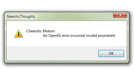

BOBL, I forgot to mention upon opening GT I get this notice. Dan
Re: New Release Version 4.90.02
Hmm, that error usually indicates a video card driver thats old,..or a video card thats very old.
Does the program run after that error?

Art, yes it does and as I said I can generate the 250 tooth gear but can't get a dxf file. Dan

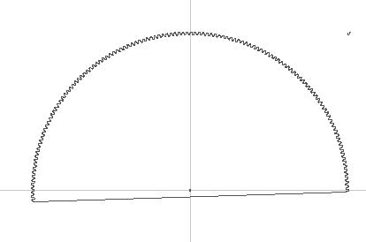

Dan;
I also encountered a problem when I tried to export your dxf, what I got was only half the gear... Weird.. Maybe Art can shed some light of perhaps why that is?

Art, I am making a drive for a solar heliostat and need a four foot dia. half gear with small teeth about 1/4 or 3/8 inch nothing critical. Also about a 2 inch or so pinon, again nothing critical. Thanks Dan
Ill leave the pinion to you as I ditn see tooth cnt..but heres a dxf of a mod5 245 tooth radius of 2foot
so 4' dia. Seems to work fine here. Youll notice at that size the teeth are basically pressure angled
straight teeth..thats normal as the radius to tooth ratio is very very high..
