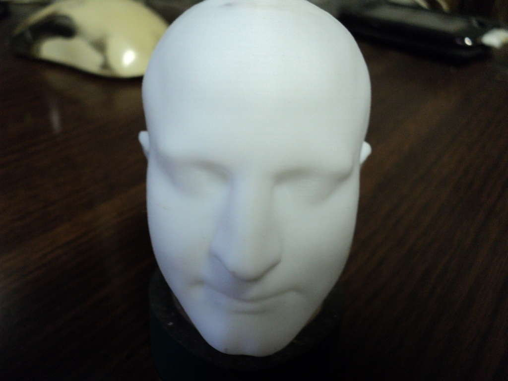

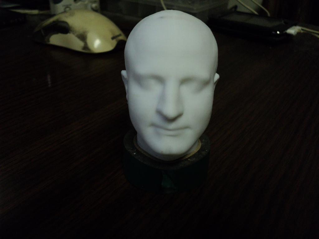

Couple more photo's.. This is the guy you see on your screen in GT..
Again, Hollow with no support inside, 2 supports held it up while printing..
About 2.5 hours to print this one in the finest resolution..
