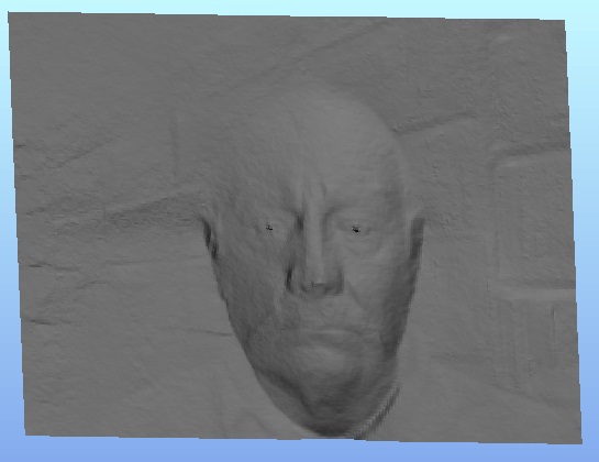

All the resolutions are back, only one copy of each. Iterations are seriously fast at 320x240.
Here's a random old bald guy who wandered through and volunteered.
I've never had snapshot work, all I get are all white blank images. I have to do screen captures and crop them in mspaint. Latest video drivers with a Radeon HD 2400.

I hate to be the one to point it out, but have you noticed that we bald guys all seem to look alike in Stereo Photometrics?
Karl
