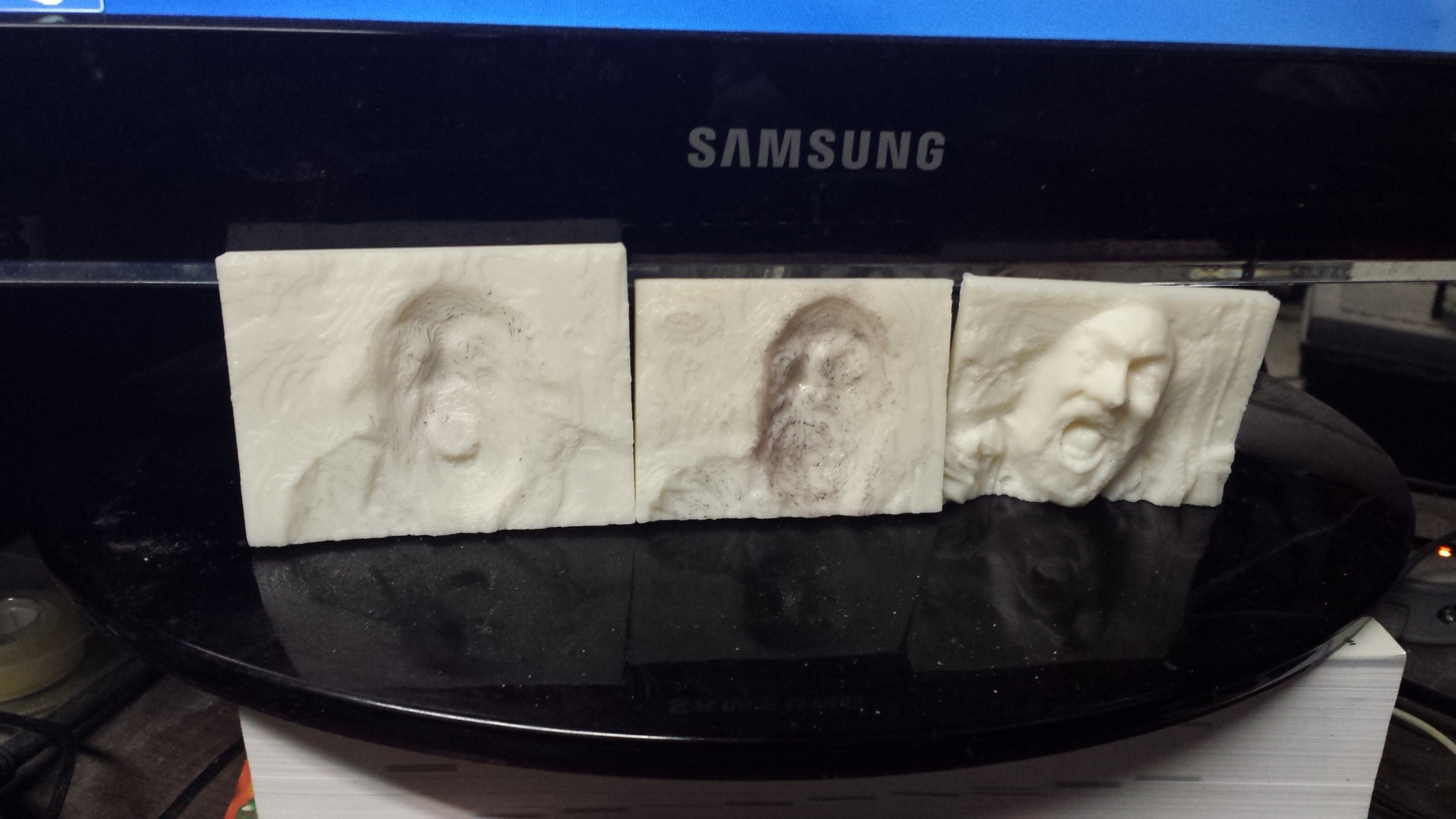

But heres another teaser photo. Three items, 2 of them are "innies", one is an "outie". The innies show 3d hologram effects and are very erie..
the outtie is just a nice 3d sculpture..
edit: Camera shots just dont do them justice, the innies work with shadows, the camera is too good at killing shadow.. :)

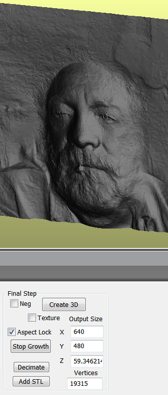

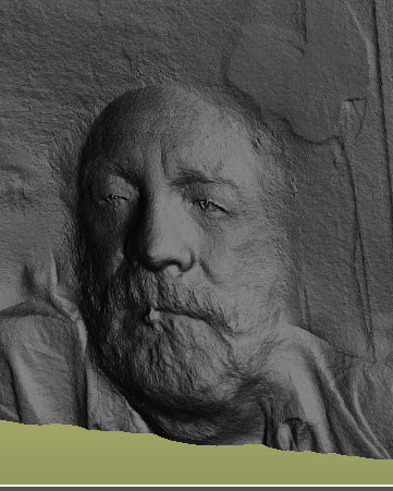

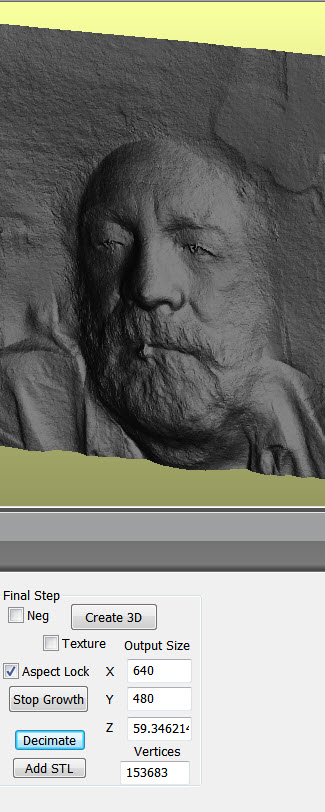

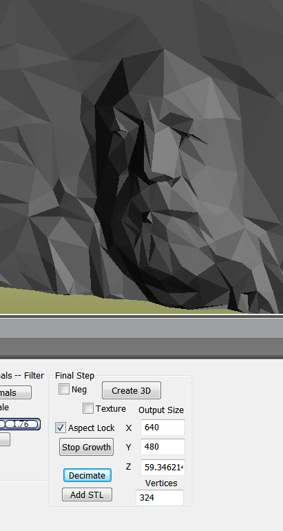

heres a few photos showing what happens to my head as I decimate from 300,000 vertices to 324 vertices in binary steps of 50% reduction.. You press a button to divide the
vertices by 2 each press.. Here what happens starting with one at 300K..

So as you can see by the progression, lowering the vertex count really doesnt hurt you till you get down to about
10% of the original for most usage. This will cause me some trouble with remeshing to create the image on a
pedestal for printing.. so Ill be delayed by a few days in release. Other than that its ready to be put out.. Worth
the delay I think.. its much easier to deal with smaller objects that have pretty much the same detail..
