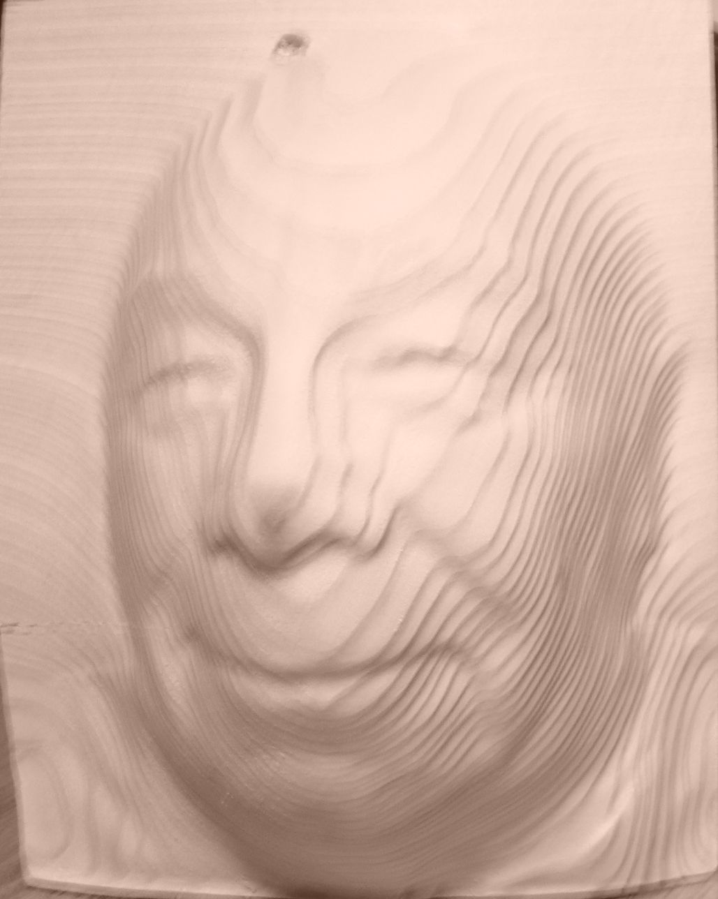

Here is my latest project. Same subject. Moved camera to center of screen. Let the Gearotica iterate all night long. I used a .0624" ball nosed, 2 flute end mill for the final pass. I am very impressed, but still want more detail.
Now I think I need to find a primer that I can paint on to remove the wood grain while not filling in any detail. Any ideas? Also a much smaller cutter is needed to get more detail.
I need to know where I could find High Density urethane foam? Would normal foam sheets from Home depot work? Seems like it would be very messy? I am also somewhat limited by a 2,000 rpm spindle!!
Karl

Karl:
Very nice...
As to methods, so far Ive only played in foam, and one in wood. Dark wood doesnt work very well I find.
The Foam is the best, check with a sign shop, they may sell you a chunk, its very expensive..
The Foam from home depot does work well actually, and without as much mess as youd think, but the real
sign foam powders away like fine white sand. I find so far the best effect is on any material thats flat in texture,
shadows well without specular highlights..
Let me know how you make out. Im investigating in my time off possible ways to make all this much better..
