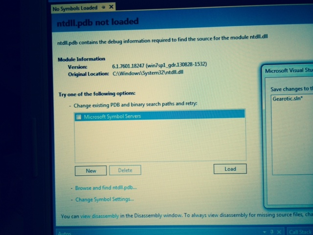

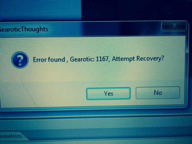

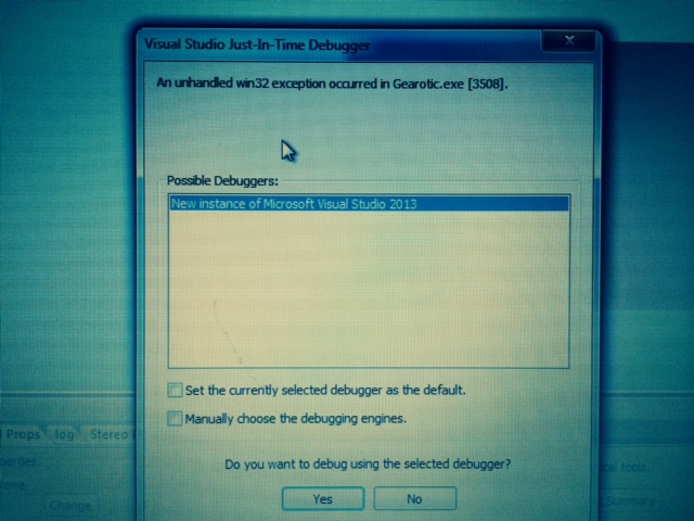

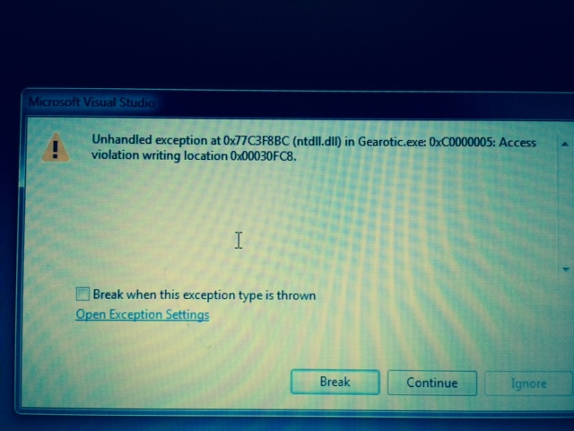

Re: Version 2.298 online.
Here are the error screens I got (in the order they occurred) after the last crash.
I bought a MicroSoft LifeCam and still have no text to the right of the screen resolutions and 640 x 480 Maximum.
The current picture I have it evaluating, I turned the camera 90 degrees instead of black taping the lens.
Karl
Karl
