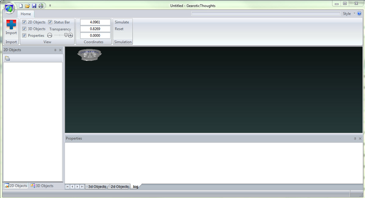

I just down loaded the latest version of GT an opened it and got this screen Where do I start a spur gear? thanks Dan

Hi Dan:
Hmm, for some reason thats a very old version of GT.. Did you download the "development" version link?
If you select the ? or help/about icon what version does that one report?

Re: New Release Version 4.90.02
It is version 1 I'll down load again and see if that fixes it. Thanks Dan
Thx. It should look as in the video I just released on Toolpaths.

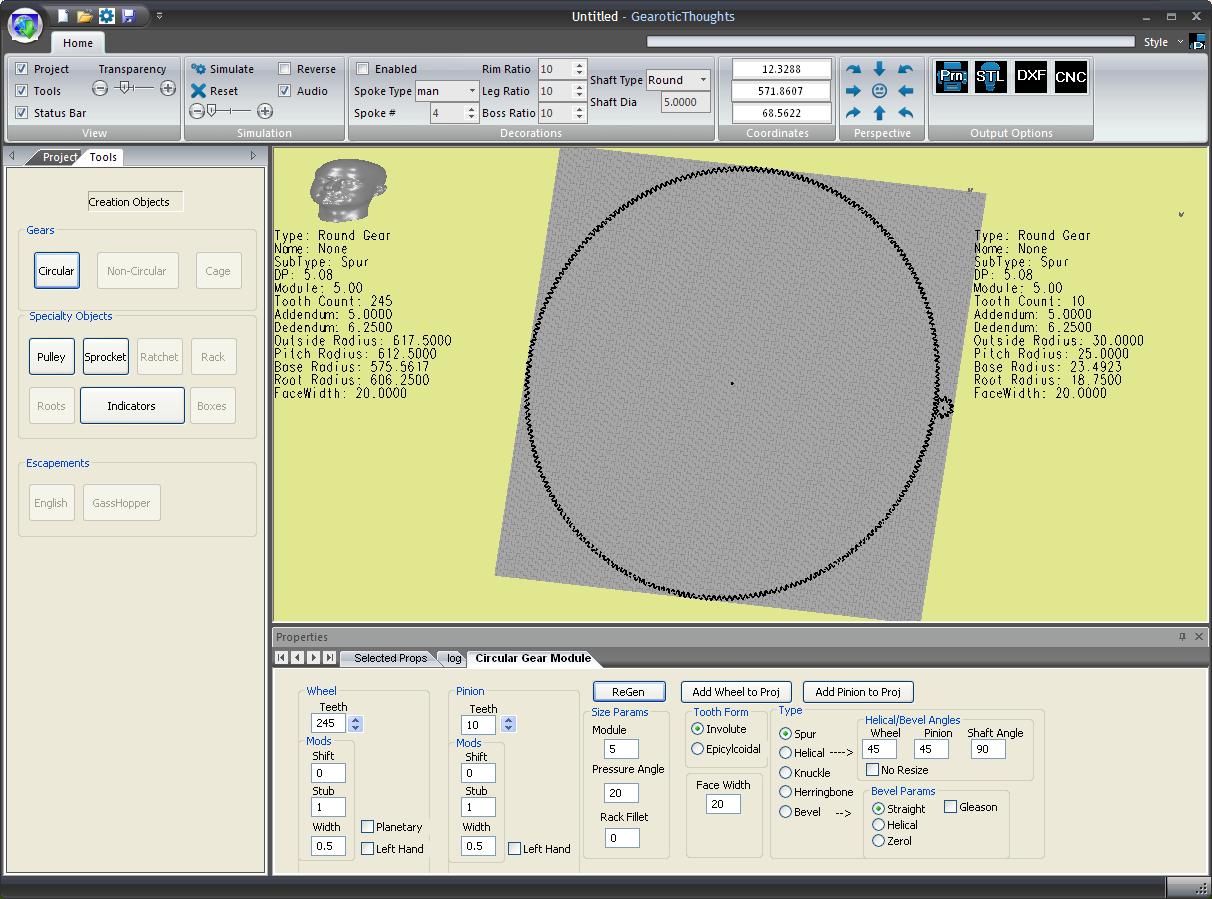

I down loaded the development release it looks ok but I can't save a gear to dxf? Dan
I just tried the same gear in GM and output to dxf and GM crashed. I have'nt used ether program in a long time and it is mad at me:>( Dan
Might have to do with the number of teeth being too high. I am needing a gear for a heliostat drive that is four foot dia. and about 245 teeth. I used the spur gear that popped up when I click circular in tools. Is there a limit in GT or is it computer horse power? Thanks Dan
Computer memory would be the limitation Id think, GT has no set limitations, it will try to create whatever one dictates..
Hi Dan;
Tried it here, seems to work for me using GT..
