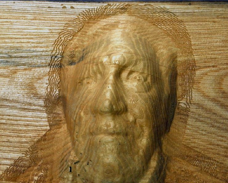

I'm using the Logitech 9000 camera on win8 64bit system
here is a 7" high 14" wide 2" high cutout in a half log
roughed with a 1/2 ball and semi finished with a 1/4 ball
1" depth of cuts on the 1/2 ball (2 passes)
.1" on 1/4' cutter (1 pass)
about 5 hours to rough it out.
6 hours 40 minutes final cut .015" ball 15 degree conical end mill (.005" step over and .005" step down)

Re: Version 2.298 online.
long cut time.. but man..thats an excellent sculpture..
thanks guys, still has a ways to go to please me. Sure does have a lot of possibilities.
