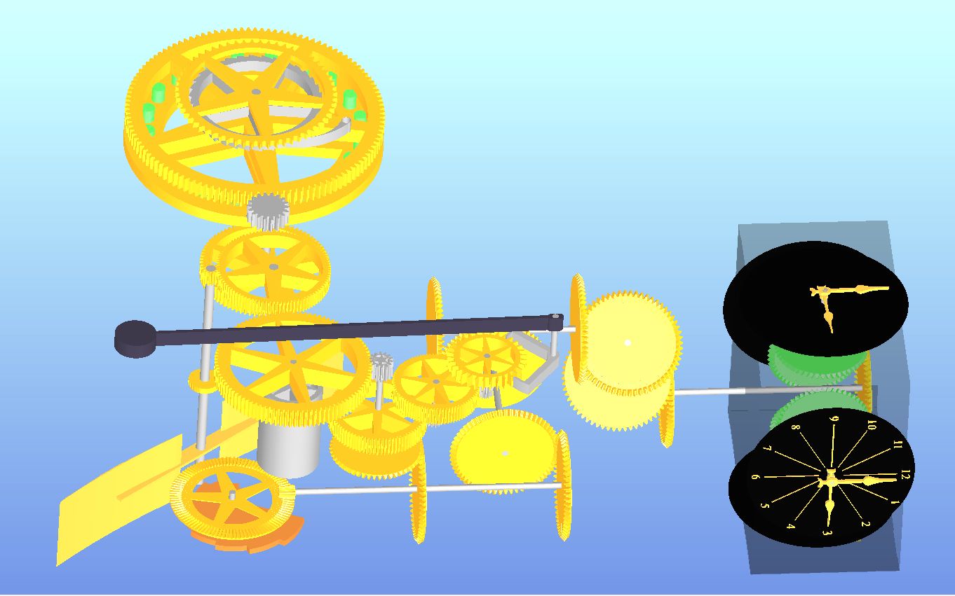

I created a large simulation of an E Howard Company Tower Clock earlier this year using Gearotics.  This simulation is being used to document the design of an existing tower clock.
The goal of this post is to not only share my large Gearotics simulation model of the tower clock  but also to share custom indicators and a gear library that I created in support of the simulation model.  The model is stored on a google drive and the following  is an unrestricted link to the GTH file because the file is too large (size ~100MByte) to directly post on the forum.
https://drive.google.com/open?id=0B8aAv ... 0J0TGp5WHc
Included in this post are :
1. Jpg of my EHowardCo Tower Clock Simulation
2. PDF  EHC-Simulation-2016-0606
3. PDF  MyCustomIndicators-2016-0606
4. ZIP  MyGearData.zip
EHC-TowerClockSim
The first attachment jpg is a screen capture of the model.  If this strikes your interest then read the next two PDF files.
EHC-Simulation-2016-0606.pdf
This file describes some of the design features and trade-offs that I made while constructing the model.  I do plan to write-up a functional description of the operation of the clock at a later date.

Re: Gears and specialized indicators used in a E Howard Co Tower Clock simulation
Bill:
Very nice. Is that flutter wheel used to simply slow the chiming chain? Good idea there...
As usual from your end, much better than I could have done, your a patient crafter..

The "flutter wheel" is trying to simulate the look of a vane.  The vane on the clock serves as a governor for the strike side of the Tower Clock via air braking.  The angle of the vanes are adjustable which would change the speed of the strikes.
Bill:
  I did, looks very good. I really must try to make those sims shorter files some day, but then they contain a lot of info on each gear..
