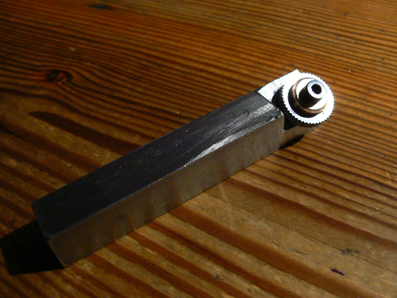

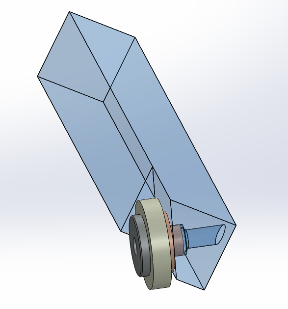

I made this tool, see example pics
Hessel

Even better is to use a knurling wheel which is not pressing but cutting !
Such a cutting wheel is commercially available and the toolholder can be self-made from e.g. a simple square steel bar.
See for example: https://www.usinages.com/threads/realis ... ere.70852/
Here above it looks a bit intimidating, but in the next YouTube video the making off is very well shown:
https://www.youtube.com/watch?v=vj8pp3YJijg
As can be seen there at the end a wheel for straight lines can when positioned again in another way produce a diamont-like pattern.
