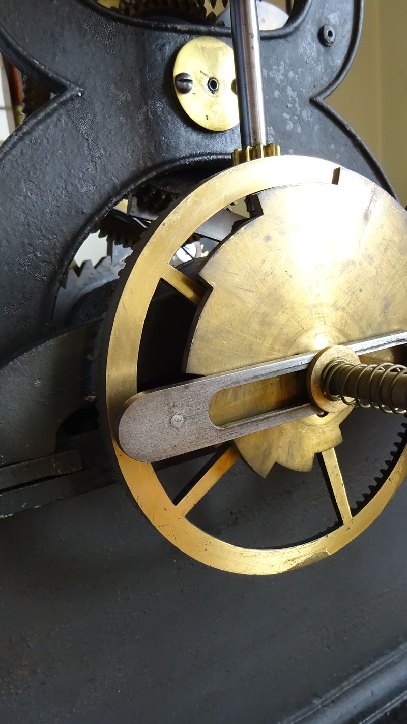

I'm sure in real power driven systems spoking of a bevel gear is probably not desirable from a strength point of view. My world of tower clocks and chronometers the amount of force is not as much of a concern although weight (in the case of a chonometer) or material (tower clock).
Attached is a photo of a "snail" that controls the number of strikes in an E Howard Tower Clock. The snail is backed up with a contrate wheel that has spokes. In previous research, it seems that a "contrate", "crown" and bevel gear all refer to the same type of gear as referred to in different applications. Operationally a pin on a bar follows the snail as it rotates synched with the our hand. The outer most step would result in one strike and the innermost 12 strikes of the bell.

Ability to spoke bevel gears
