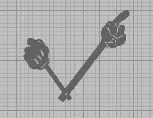

I seem to always need a very simple second hand with no muss or fuss so I followed you instructions and heres what I produced.
PS Tried to attach a .dxf of my creation but can't attach it.
Re: Indicators
HI Art,
I can see I'm going to have a lot of fun with this knowledge - probably dangerous.

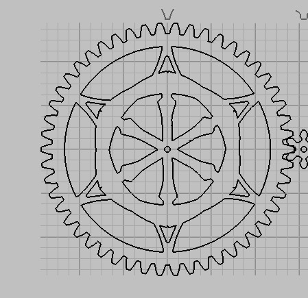

Re: Indicators
Does this work for "contributions" - or would you rather I not?
DoveJT.dxf.zip
(41.78 KiB) Downloaded 715 times
lighteningJT.dxf.zip
(14.85 KiB) Downloaded 734 times
SimpleSecondHandJT.dxf.zip
(6.27 KiB) Downloaded 701 times
spiralJT.dxf.zip
(75.54 KiB) Downloaded 720 times
Re: Indicators
  No, its great that way too. Bob will download anythign people put up, and he'll forward ones to me that look like they belong in
the program release. We'll keep the naming conventions the author uses as well. If it gets to be too many, we'll make a "SpokePack" download available
on the downloads page.
  I like the fact that users can contribute such things, and when CAD is done there will be a few more ttypes of sharable objects. :)
