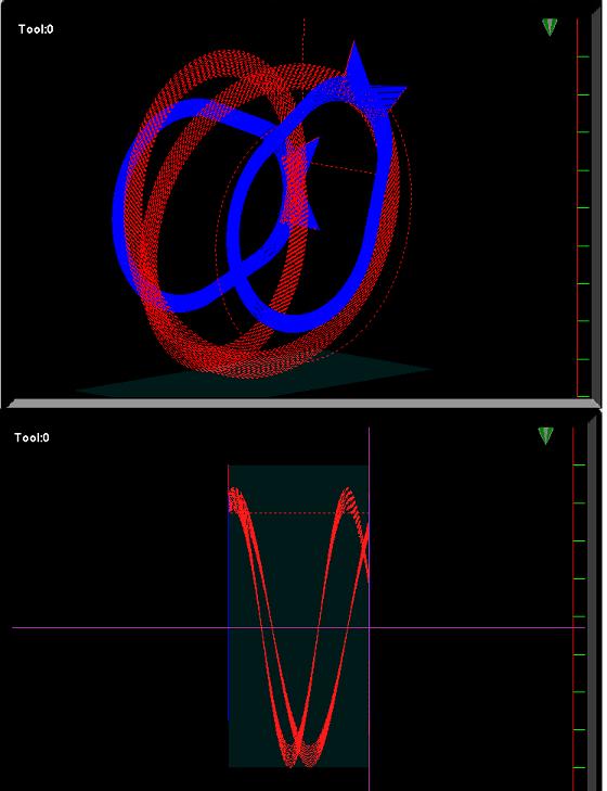

THERE are a LOT of old Profile Plate cam grinders out there that are waiting on a decent CNC interface.(;-)
It would not be Just for camshaft grinding but Cam lobes in general.
Long ago I had a version working from out of Sheetcam Les helped me with the post. We used the Function of a XY drawing of the Lobe then ran the TOOL around the profile THEN converted the X to A on post. THAT gave you the basic profile. You could STACK the lobes in layers to do an entire V8 camshaft
In mach3 I then used  SUBs to drive the program and stepped into the lobe each loop. You could also do alternate lobes each loop to equalize the wear on the Wheel across multiple lobes. At one point it did just under a Million lines of code to do a V8 camshaft.
Then you also have Crankshaft grinding where you grind the journals. Basic offset grinding there.

Here is a sample of one of the program to gind a 2 lob camshaft. NOTE the cross over between the 2 lobes. after each loop around the lobe it trnsfered over to the other lobe did one loop around it then return to the first lobe
Re: Cam Grinding coding
Thats clever....
