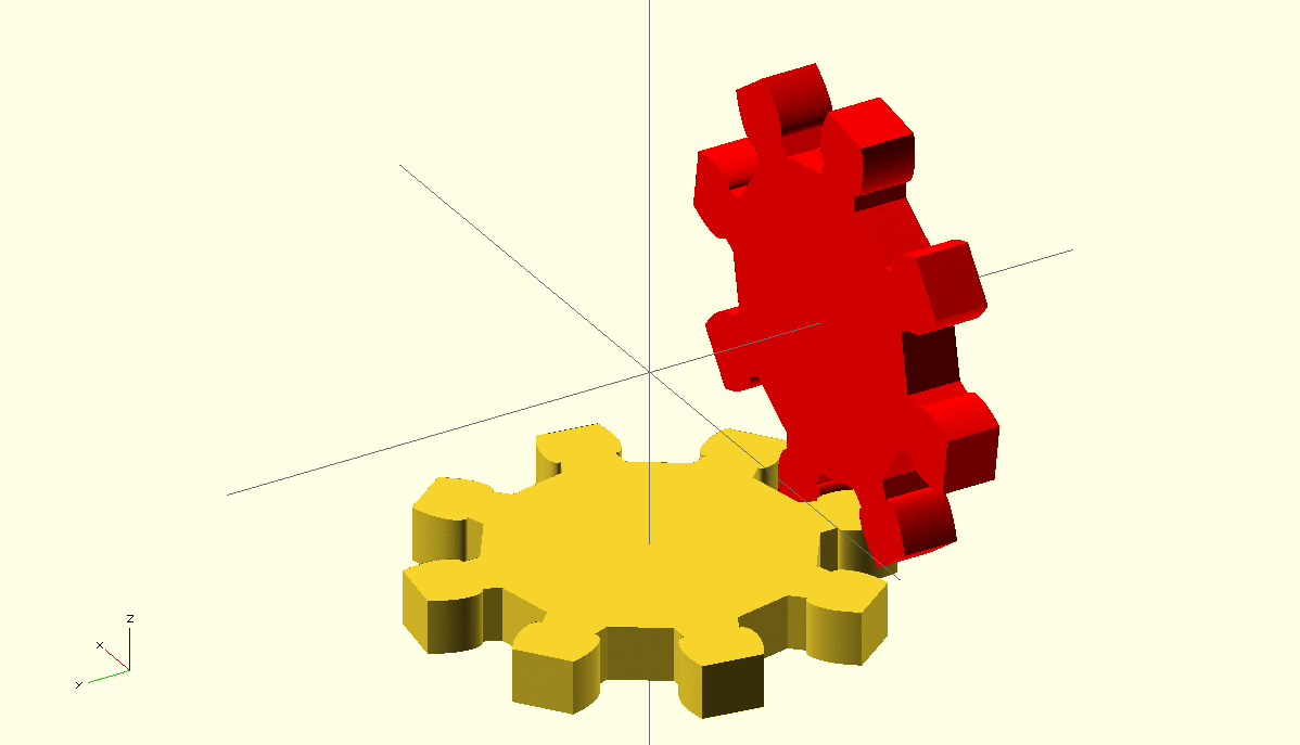

More fiddling... I guess they don't need to be peg gears to work as 'straight sided bevels'.

Much better, I think they have the benefit of running on a single line of contact.. and really at any
angle of bevel..

The contact properties really aren't ideal, but I guess that's expected. They are straight-sided though, so it should be possible to make a set on a CNC set up with an untapered end mill.ArtF wrote: Much better, I think they have the benefit of running on a single line of contact.. and really at any

Has me wondering if the perfect bevel isnt spherical teeth, any angle woudl have a single contact point... :)

I'm not sure what you mean by "perfect bevel". If you can mill profiles, proper involute bevels will be better for fixed angles because they have contact along a line. If you want to 'act through a hinge' these pseudo-involutes should have a single contact point at any angle already.ArtF wrote: Has me wondering if the perfect bevel isnt spherical teeth, any angle would have a single contact point... :)

I guess I should have said universal, if the teeth where spheres I figured they'd work at any angle or an angle thats varying, as you say..like a hinge.. But true, these shapes would also have a single contact point.
Re: Crown Gear
As in literal points of contact that would be very small percentages of the entire surface area of the teeth. The material would have to be very hard faced and lightly loaded to be of practical use.

True, for some reason ball bearings came to mind.. but then everything I do tends to be very lightly loaded decorative type things. :)

Yeah, it's optimized for easy manfacture (laser cutter or straight mill) rather than good mechanical properties.JamesTSG wrote: As in literal points of contact that would be very small percentages of the entire surface area of the teeth. The material would have to be very hard faced and lightly loaded to be of practical use.

But OTOH, rounded tooth gears would tolerate a variable angle of rotation much better than conventional gears. I'm not sure why you would design a mechanism that needed to, but... there you go.

Yeah, thats what I meant by hinge effect.

CV joints do something similar, and see a lot of use in cars. They do require free balls rather than fixed ones.JamesTSG wrote: But OTOH, rounded tooth gears would tolerate a variable angle of rotation much better than conventional gears. I'm not sure why you would design a mechanism that needed to, but... there you go.
I don't understand how 'spherical teeth' would provide an advantage if they're simply fixed teeth on a pair of gears.

They have an undefined (but small) contact surface and engagement angle. Conventional gearsets have a fixed angle relationship. Deviate by even a small amount from that and bad things happen (uneven wear which induces slop, hooking, broken teeth, etc.). You would not use them on anything but a CV type joint/pivot.Nate wrote: I don't understand how 'spherical teeth' would provide an advantage if they're simply fixed teeth on a pair of gears.
