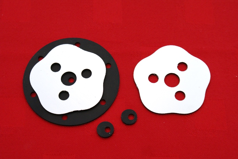

Well, I have made a start ;D
I tried laser cutting but the dimensional accuracy is just not there so resorted to milling. Once I get a few parts machined and assembled I will take a few more pics.
Re: Cycloid Reducer.
Tweaky:
Dimension wise I was of the opinion one should enter a pin diameter slightly larger than that they intend
to use. The drawings are done with zero allowance. I expect a backlash is required to allow for at least
some tolerance. Other than that they should ( math wise anyway ) work out well.
Love to see your end product.. :)
How did you make the back plate and eccentric inserts?
Hi Kirk,
The stator had the OD added in Vectric with the pin positions from the Vexx DXF.
The cam was produced in Vectric using the offset displayed in Vexx.
I am not yet sure of the best way to achieve the running clearances - a system I used from a previous project was to lie about the tool diameter when creating the path but it needs a few practice runs (trial and error) - I think I have plenty of engraving laminate in stock so that is what I am trying ;D
Hi Tweaky:
When designing it, say you want to use 5mm outside pins, declare them as 5.25mm pins. Then
cut to profile for the toolpath. You should get a .25 clearance. Though thats basically the same
as you just defined only from the tool side.
I use about that much for my laser..
Many thanks for the info.
I have yet to make the drive disc but I am making progress albeit very slowly.

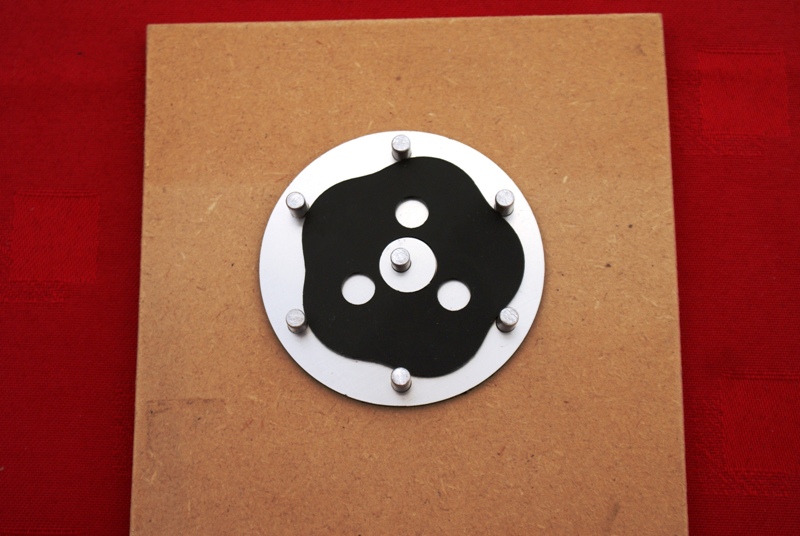

Tweaky:
Looks pretty good. Ill be interested in how you find it works.
I have a few lazy susan bearings that will be used as my
axis drive. They have a large enough hole in the middle to
contain the center bearing and should ease that rotational friction
you may hit with the small offset circular parts.
Keep posting your experience.. Ill post my first stage when
its cut.
You know I have a conjecture on the number of pins needed to
be used on the outside ring. If, for example, you use 21 outside pins,
you get a 20:1 reduction, but my thought is that you need use
only the number of pins in construction as determined by torque
requirement. The number of pins used must be (n > 2) for any
ratio above 2.
So a 20:1 reduction could in construction use as few as 3 pins
if the torque requirement is low. I intend to use 3 pins on each
of 4 stages to reduce a clubfoot to the hour hand.
Dunno how that will work out, but simulations seems to show
a min of 3 should do the job.
It?s early days yet (for me) but I had planned for ball bearing the cam (shaft and outer) but (from my model) observation shows that although the cam will roll on a pin the exact opposite side of the cam slides on a pin and there is quite a lot of friction there especially as I plan on dual cams / rotors. Looks like my pins will be ball bearings as well and while I am at it ball bearings for the final drive dogs.
It could turn out to be a neat little reducer but it is going to be heavy :)
A few seconds of poor quality video, just to prove that it works ;D
https://youtu.be/u3Mh1E4GgHE
