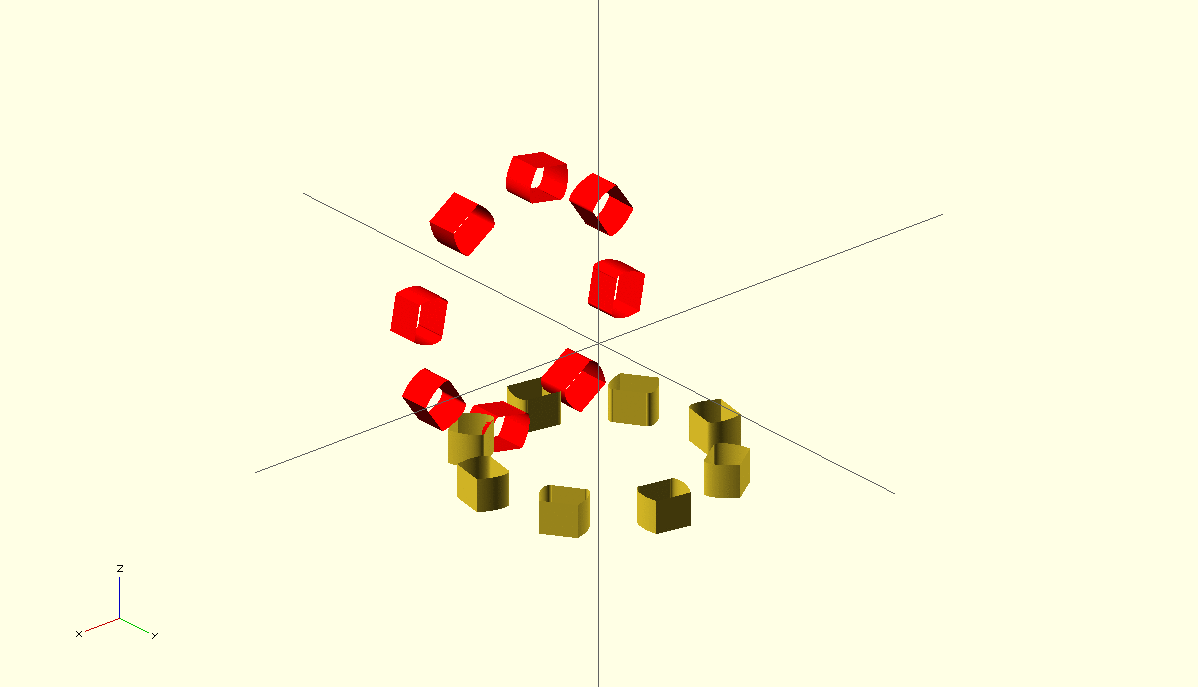

The approach I'd been originally thinking of seems to involve undesirable undercuts.
How about using "improved peg gears" as crown gears?

More fiddling...  I guess they don't need to be peg gears to work as 'straight sided bevels'.

ArtF wrote: Much better, I think they have the benefit of running on a single line of contact.. and really at any
angle of bevel..
The contact properties really aren't ideal, but I guess that's expected.  They are straight-sided though, so it should be possible to make a set on a CNC set up with an untapered end mill.

ArtF wrote: Has me wondering if the perfect bevel isnt spherical teeth, any angle would have a single contact point... :)
I'm not sure what you mean by "perfect bevel".  If you can mill profiles, proper involute bevels will be better for fixed angles because they have contact along a line.  If you want to 'act through a hinge' these pseudo-involutes should have a single contact point at any angle already.
