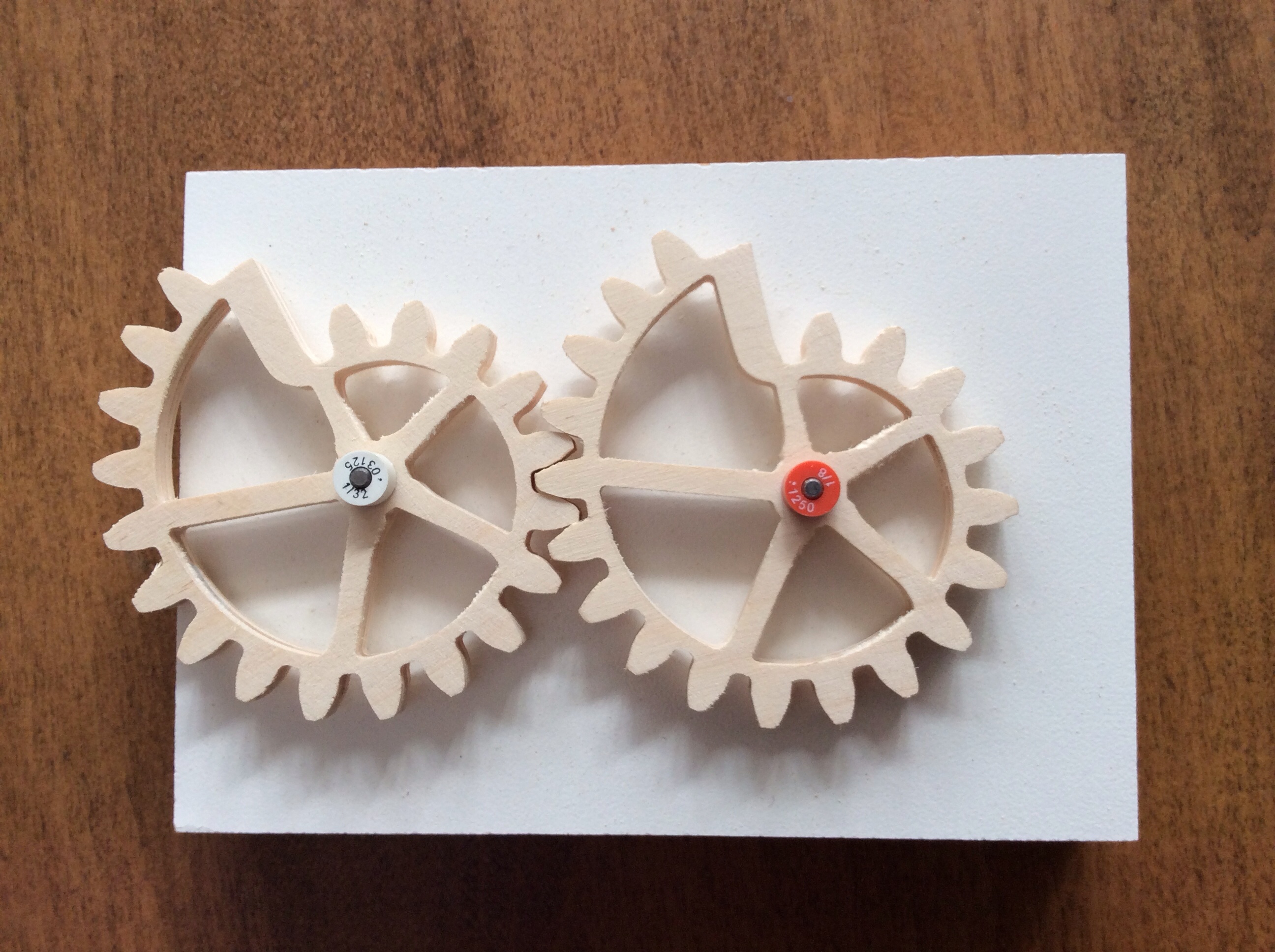

Many Thanks.  Had to go into the folder and run the vcredist. It must have worked because I have been able to produce this (see photo).

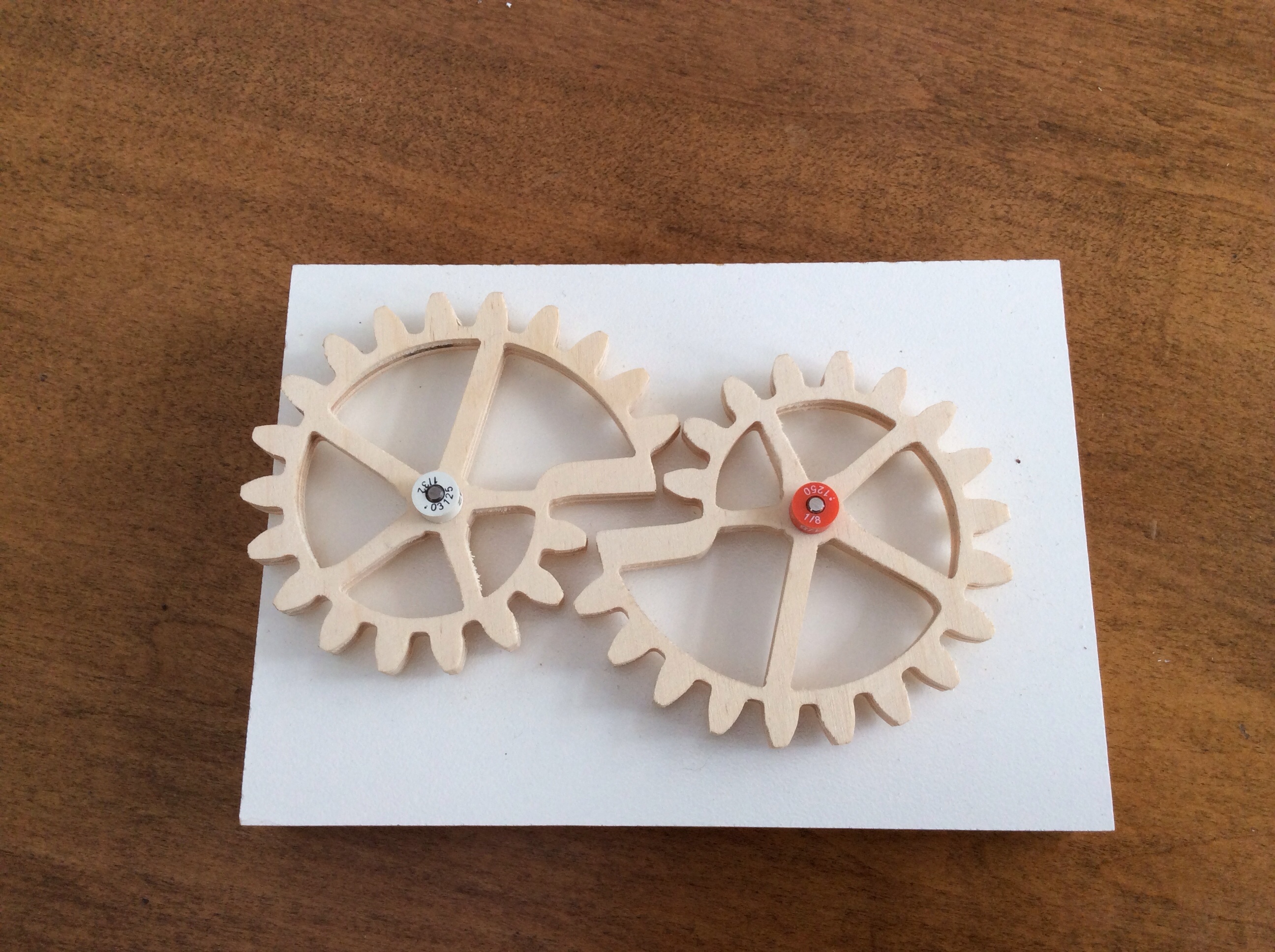

That's right, should never have to run vcredist again. I have a question however, does these gears kind of snap lock together as a result when the two long flat surfaces mate? The 3D printed ones we got here kind of do just that, just curious if that goes for wooden cut ones also, or if its just material related effect?

Hi Bob
There is a "magical" point - just as the flats come together where you can "unhook" the gears and lose their mesh.  Put the flats back together and they mesh again.
At the same time if you rotate them with your finger in a continuous motion, even slowly, they will stay meshed with no problem in either the clockwise or counter clockwise directions.
Just another point, I didn't use the program to give me the shaft locations I did it empiracly, which is to say I adjustec the spacing til the meshing felt good.

  Way to go, perfect creation as far I can see. :)

John;
Thanks for the feedback, they do look perfect..
