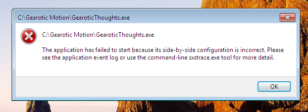

Fresh install of latest dev version creates attached error when attempting to run GT on win7. GM works fine.
Maynard

Hi Maynard:
  You need to run the 64 or 32 bit runtime for windows. The install should have asked you if youd like to run it, so reinstall then tell it to run the VC runtime install at the end of the install routine..

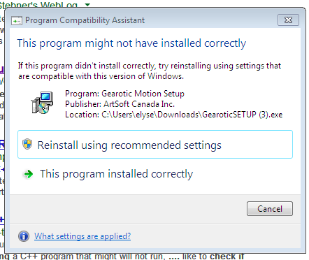

Re downloaded and re installed. Getting same error. Got following(attached) dialog during installation. Selected "reinstall with recommended settings". System is wn7 32 bit. How do I tell if the runtime is installed, or install it separately.
Thanks Maynard

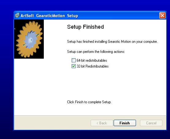

Maynard;
I beleive once you start the installation of Gearotic Motion on your computer, at the very end of the installation it will show the setup finish dialog box shown in attached picture. Here un-select the 32 bit redidtributable and then select 64 bit instead.  Please let me know if you have any issues..
