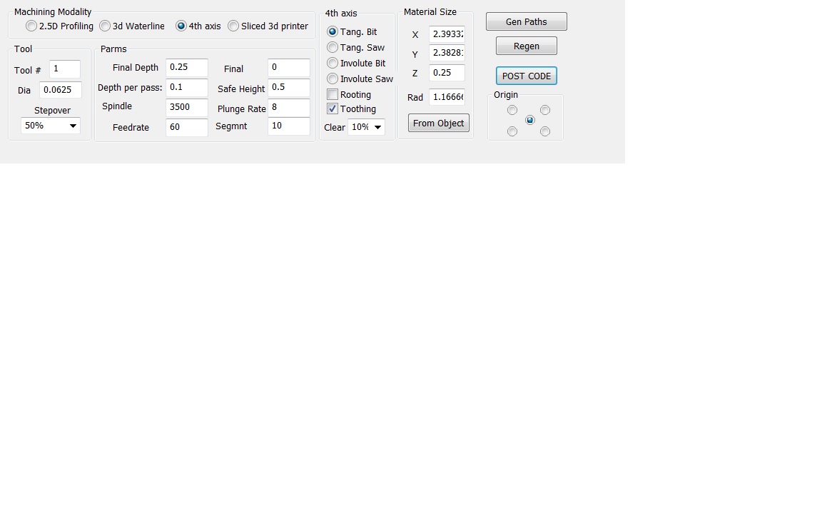

2. If you change the material size it is ignored. For example, I made my gears narrower than in the project. I changed Z from 1" to .25". It didn't change in the posted code. I assume that's what the material size is for...

As for the material, its really just a display setting, to change the code
you need to change the depth box for the cut..

I tried changing the final depth to .25 and that did not have an effect on the resulting gcode. FYI, naming gears and the new font seems to work quite well.

My appologies, your quite right, the gear in 4th axis is cut to the thickness of the 3d gear that was created.
I will add to my list to change that over to the depth box setting..

As of next version the FinalDepth parameter will control 4th axis spur cuts thickness. This allow for quick changes
to thickness as well as matches the spurs on 2.5D in that finaldepth actually controls their thickness as well.
(This does not apply to helicals, herringbone or knuckles or bevels as yet., just spur gears, pulleys, etc..)
