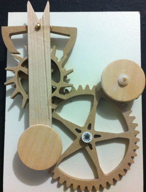

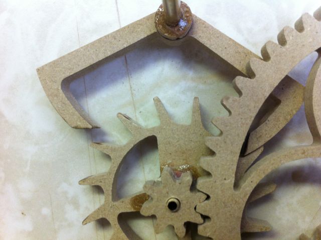

Hopefully this photo will explain better that my words.  All I have done is leave the pallets the way they were cut but taken the escape wheel and turned it upside down.  Since this is a fidget I am able to look quite closely and the action and it seem to me that if the pallet face were just slightly longer I would have a recoil escapement.

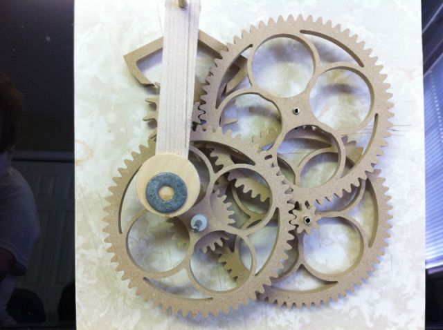

Just as a test I've built a small clock mechanism and it definitely will work and will easily run on finger pressure.

Thats excellent. I hadnt ven thought of reversing a deadbeat. Nice thinking out of the box...
