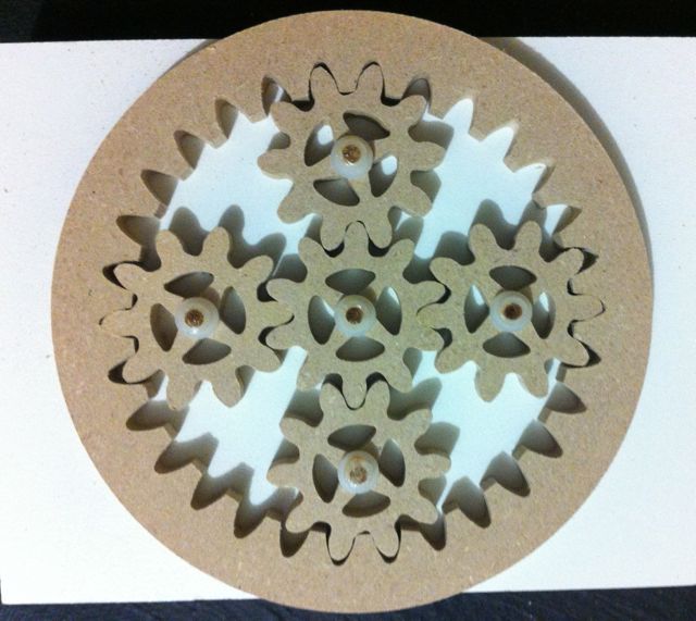

I've built a couple of standard spur gear planetaries.  They mesh like a glove, however my question is - does the backlash work when making a planetary?  The Planetaries I have built are really tight, and they free up a little when worked but I would like to build in some backlash.  I've tried a couple of settings on backlash but it doesn't seem to make any difference.

I've done some more experimenting with the backlash on a standard spur gear planetary and the inner gears handle the backlash perfectly however that backlash does not seem to translate to the outer ring gear,  that is probably one of the reasons my planetary was too tight, the inner gears were spreading out and the outer ring gear wasn't accomodating the new spacing, I'll probably have better luck with a very minimal backlash.

  Glad to see the backlash is better. The planetary doesnt actually spread anytime in backlash, all backlash really
does is add shaft distance so it draw the inside gear away from planetaries edge.. even that can cause hard running
in some situations.. Ive noted this on my list to look at as well.
