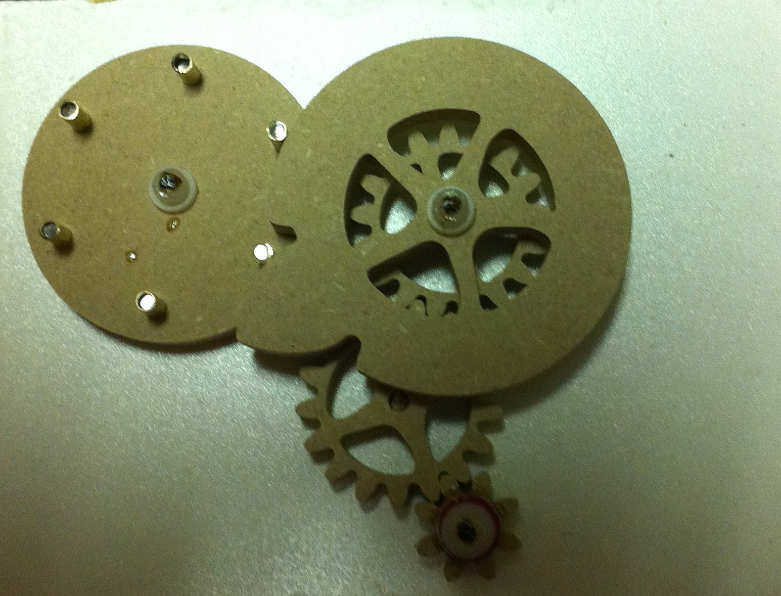

On the little set I've made (fit on a 4 by 5" mount) I've had a problem of the pin just bumping into the Geneva and not sliding down into the pocket. I've "carved" it out until I get the motion (slides into pocket) but obviously that's not what was intended I'm sure.
The lantern in 1.25" on the DP and the Geneva is the same.
My question is - Is there a lower limit to which the Geneva's should be cut or is it just the material I'm using (MDF)?
PS Still having fun.

I've made a Geneva with rollers and while it does turn a lot easier, it still seems that the roller strikes the geneva tooth at a very steep angle - doesn't look like the 45? you said you thought it would. Am I doing something wrong?
Re: Geneva Size Limitations
Looks liek your hitting just above 45 degree's..not your problem, more mine.
You ve proven I think that the angle is less than optimal. I may have to change it to a
much lower angle to work smoothly. The problem is that its a tradeoff. Look at this
more typical example of a geneva inverted.
http://newgottland.com/2013/02/06/inver ... ecahanism/
As you can see my design tries to eliminate as much of the "looseness" in the
changeover from tooth to lock phase. Whats your opinion, you have more experience
at this point that I do in terms of how the inverted design runs? Woudl you like more
"looseness" factored in to get a more hi power changeover hit angle?

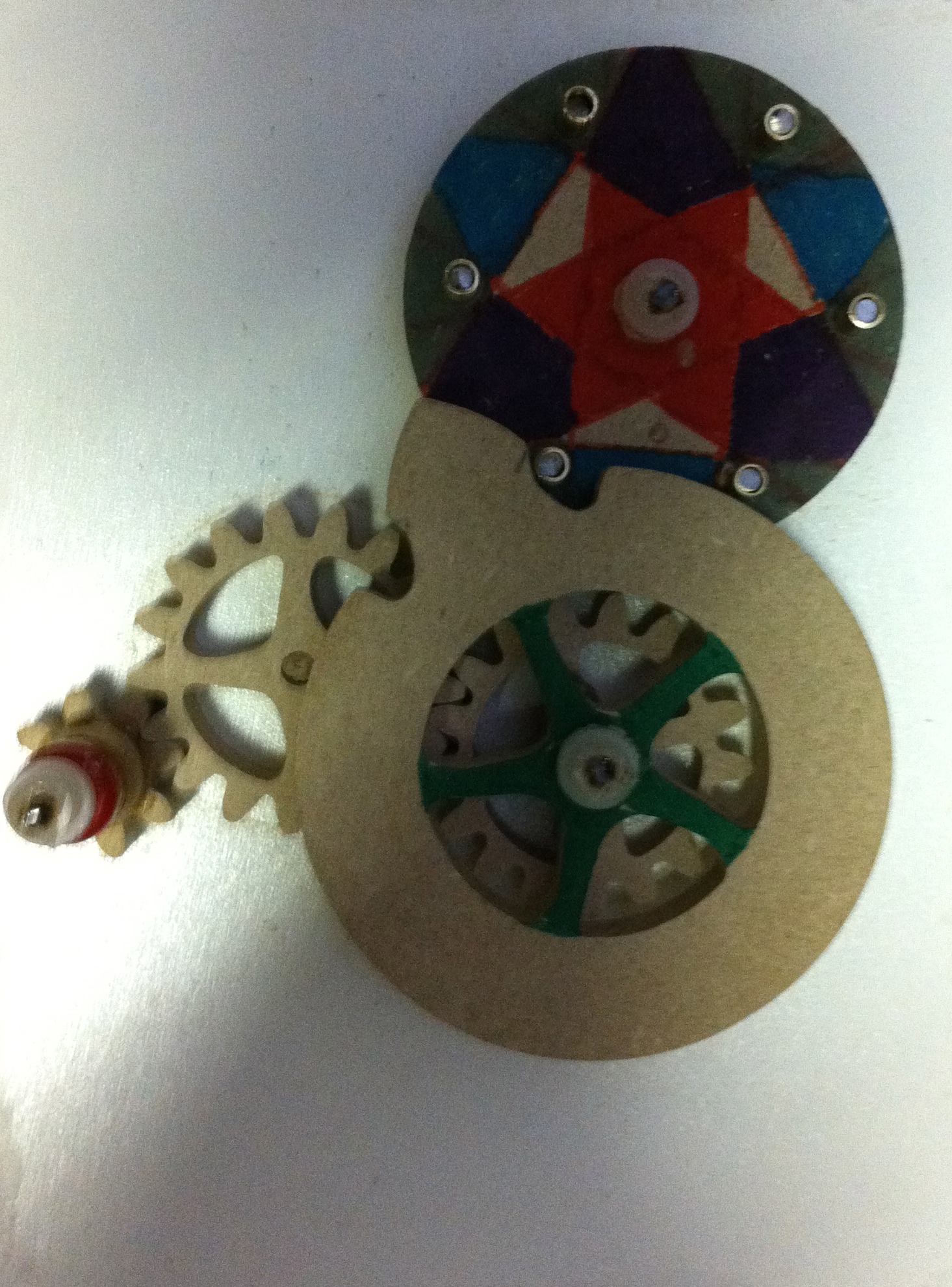

I like how positive the action is "lack of looseness" its just the actual entry of the pin on the tooth. To get the action and feel that appeals to me I've "ground" in an approach that is more gently. Since I don't have the vocabulary I'll post a photo instead. The pencil marks were put in to mark the initial contact and then ground down toward the gullet. I made no change in the actual gullet nor the tip just the "approach slope. A very slight rounding on the exit slope stopped in binding on the way out.
Forgive the colouring - I was bored.

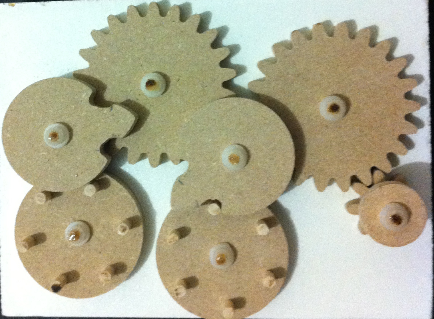

I thought I'd try something - I made a Geneva wheel with 4 teeth spaced as close as possible. The entry into the teeth has the same bumping problem but once the teeth are engaged its smooth as silk. I don't know if this helps you but I thought it might.
Yep, thats the tradeoff, between a positive locking action or looseness. I like your solutioon though, that looks like it lowers the pressure
angle enough for a more posative engagement. Ill see if I can roughly duplicate that within a couple releases. I appreciate that kind
of feedback, saves me gobs of time..
