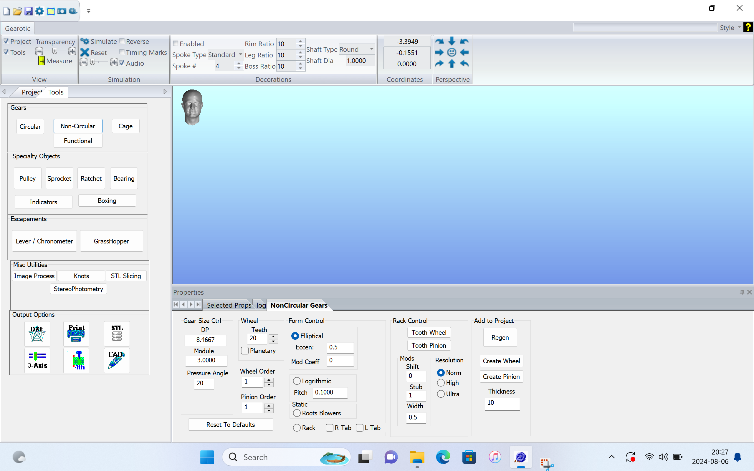

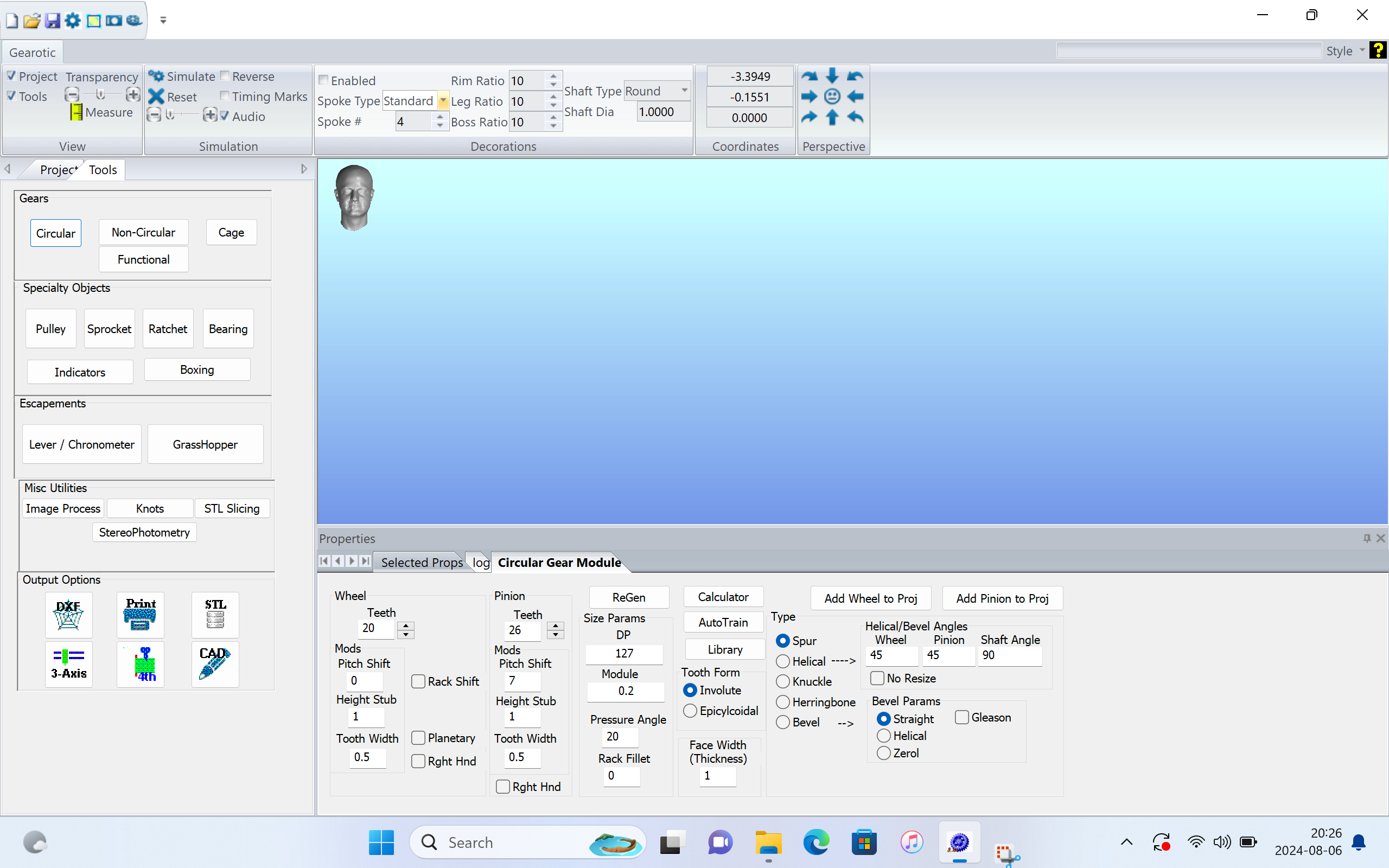

Hi!
I was on "Circular" gears, elaborated with wheel and pinion tooth width.
I was away from computer a short while and when returned back, Gearotic software just didn't work...
The main window just doesn't reflect what's in the Properties window.
After several restarts and testing I deleted Gearotic installation and reinstalled newest installation file downloaded from Gearotic website.
Still same issue (see attached images).
I assume som hidden files or similar is still on the computer since I don't need to enter my licence key you use the program.
Can someone point in any direction that may solve this? Maybe delete some hidden files from some library? As always those things happen at the most imperfect moments...
//Mike

Mike:
Very odd one. I tried to reproduce and can't. If you run the program, kill it while its running with
your task managers process tab, when you restart it will ask if you'd like to reset all settings. That may
help. Let me know..
