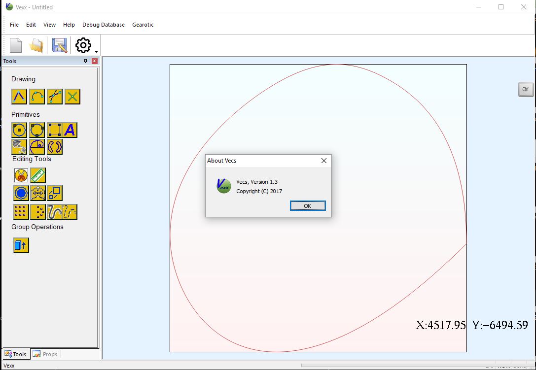

current VEXX version (which I love;-) seems to have a problem to import DXF (AutoCAD 2010/2011/2012).
I created the circle using Adobe Illustrator and exported it as dxf file.
When importing it into VEXX, the circle is no more a circle.
(DXF and screenshot attached)
Regards --- Peter
Vexx import dxf circle

Hi Peter:
Thanks for the dxf example, Ill take a look to see why its deforms. DXF is a very
weird standard as its got entities some support, some dont, and complexities that
make it hard to adapt to all types. Ill drop a note here as to what was wrong, or
fix it as Im currently working on additional features for vexx.
In fact , I will start a new topic for vexx as I find Im using it more and more
lately. While other tools exist that do what Vexx does, I find it quicker to draw in,
but then I wrote it so thats pretty normal. :)
