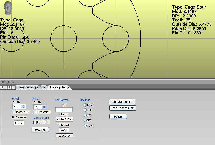

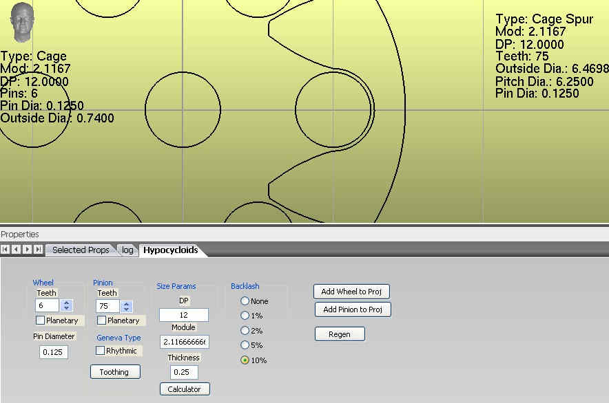

My question is - does the backlash option have any effect in this case. I can select 0% up to 10% as shown but I don't know where to look for the effect of the backlash setting i.e. what happens to the design.

I appears to be moving the shafts. I can't get a really good measurement of the shaft spacing but the best I can get says as 0% it is 3.3735 while at 10% it is 3.3537
I've attached a couple of screen shots which show the backlash but there is no tooth width options for the cage

Sorry about that , I was thinking spurs and the changes to backlash over time.
In the Cage gears, backlash shrinks the pitch circle of the hypocycloidal spur, it does
nothing to the cage gear. So in your case , using a cage with a spur backlash would
have no effect, but you can get backlash in that case by simply using smaller diameter
pins.
