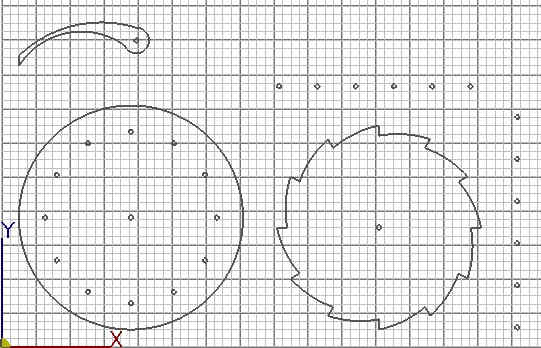

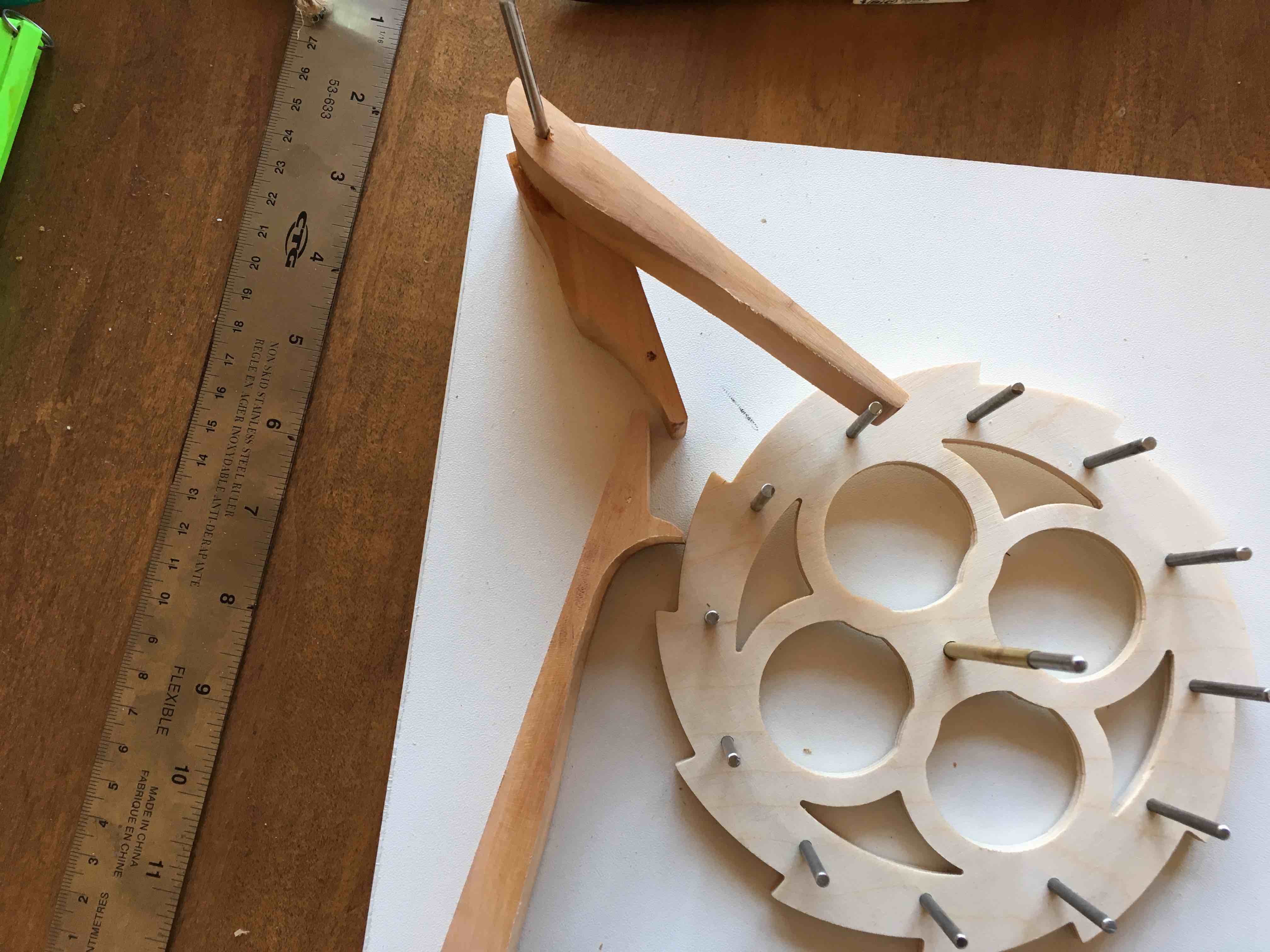

I can create the escapement by first creating a large 6 inch ratchet and then superimposing a likewise large cage wheel. The issue I'm struggling with is that I want the pins from the cage wheel but I don't want the final profile cut out. I have managed to make the escapement as you can see from the attachment - However is there anyway to select parts of the cage components and remove them from the 3-Axis CNC screen. I can select the cage wheel profile, but when I delete it I lose all the pins as well. My workaround has been to sit at the machine and as soon as it gets to cutting the profile I stop the cut.
It works, but if I could remove the final profile I would also have a really good way to make registration holes in gears so that I could make much wider gears than I'm able to currently cut on my CNC.

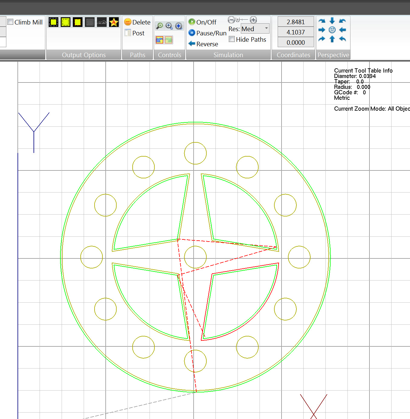

When you select a line or contour, it turns red to show its selected, you then press the type of contour, outside or inside.. and repeat as many times as you wish. Heres a photo of what I mean, one at a time
I selected the outsdide, and inside contours and pressed the button for a profile path (outside path for
outside, inside path for the insides. If your screen then looks as the photo below, pressing the post button
will make Gcode for the cage gear with no holes. Only the green profiles are put in the Gcode.
You dont need to actually delete the pins, they wont post code unless they have green outlines
showing you have commanded output profiles for them..

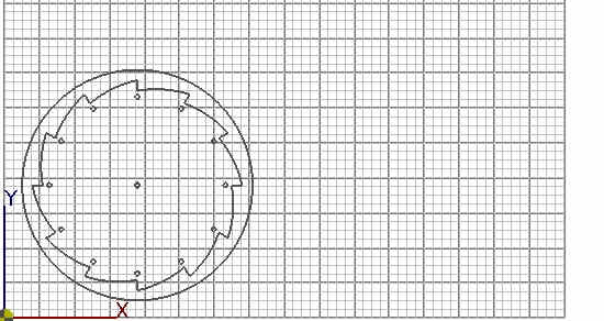

Following your instructions I have made it work. I first get the cage on the 3Axis screen and then select each pin to red and get a path for the pin hole. I do that for all 12 pin holes and then I put the 12 tooth ratchet on the 3 Axis - in a different location. I can do an automatic tool path for the ratchet and finally I can select the ratchet with tool its paths and superimpose it on the pin holes using the shaft of the cage layout as a registration point of the shaft of the ratchet - Success!! I have the tool paths that I want.
