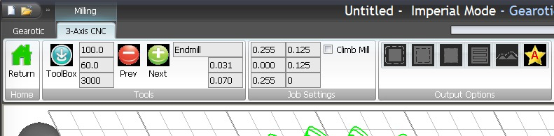

On the 3 Axis CNC screen there are 6 settings under the Job Settings area.  On my screen there is no indication of exactly what these numbers control.  I think the upper left is rapids height. Not sure what the next one is and the last is the cut depth (I think).  The lower right one is the number of tabs in the cut.
These are all guesses on my part and some emperical testing on my part so I'm not 100% sure.  Anyway I thought you posted that we could change the icon sizes but I don't know how and not sure it would provide the labels I'm looking for either.
Its not critical - I can bungle along on my own - but a little knowledge would help.
Re: Help on 3 Axis Screen
  Sorry about that. Those ribbons unexpectantly take off wording on lower res screens. TO see the text, drag the window  so its narrow, the windows will close down to drop downs, you will then see the text. Ill look into some way to fix that...
