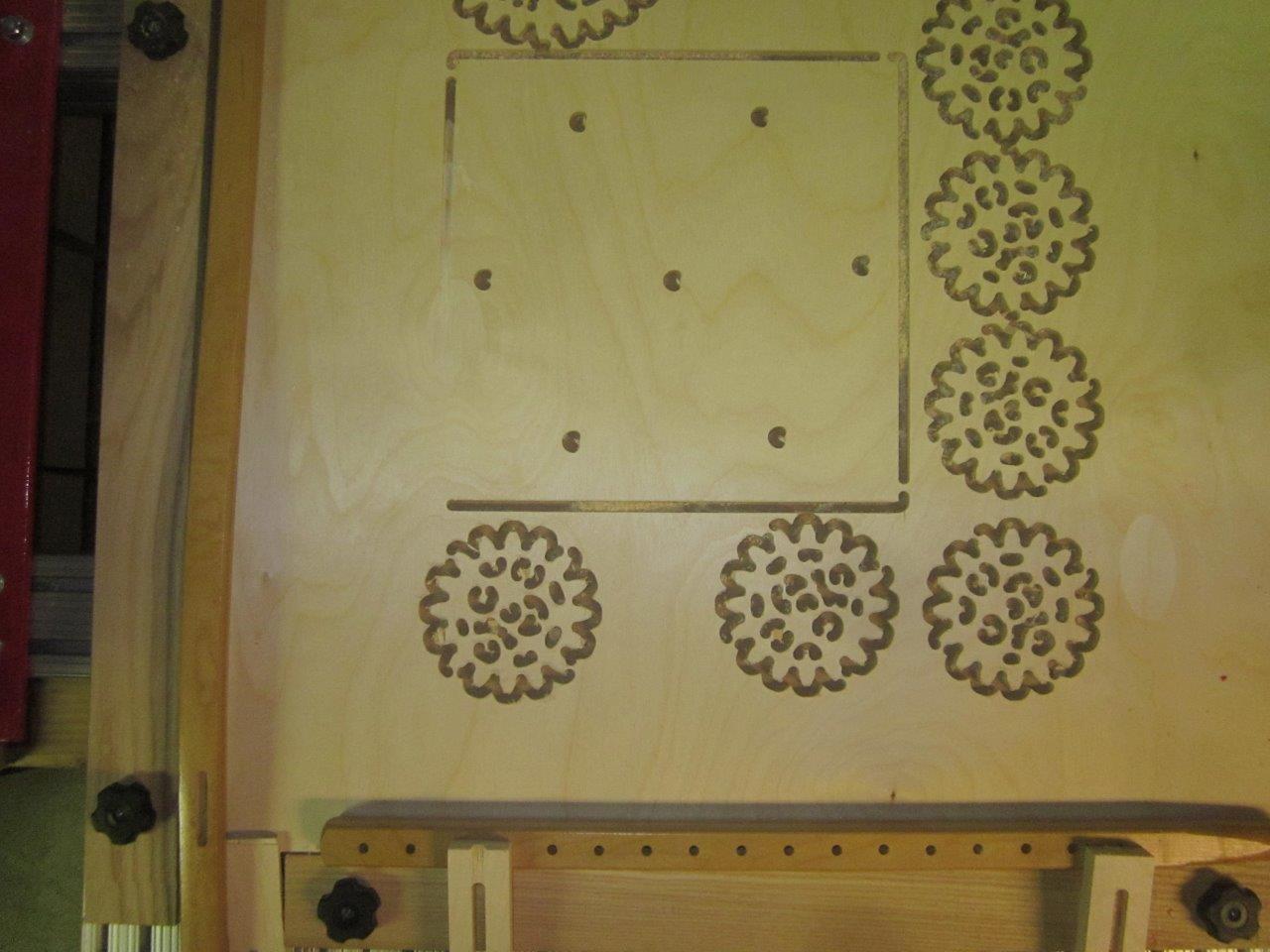

With that, I've now been able to layout my first project. I started with a few pinions around a wheel, all boxed. I sent the gears and the box to the workspace, deleted the front of the box (retaining just the rear). Highlighted them all, had it create and post the g-code. I used a 1/4" cutter so I can understand the lack of detail in the gears, but what I cannot explain is:
(1) Spoke holes aren't round. See photo, both on the rear box panel, and on the gears.
(2) The left boundary of the rear of the box didn't cut properly. See photo. Was above the surface (after cutting in the air for a sequence, see below for more on that), then ramped into the material.

That looks very much like Ive introduced a bug in the code.. Can you confrm the version that your using, Ill run
some tests and get a fix out in the morning...
Youre tabs will get thinner as you said if you make a finish pass thats less thick.. Your center holes may be affected because they were
half tabs.. I think Ill add a fix for that as well. Ill report in the morning after Ive solved the issue..

I ran a few tests here.. it seems to be working well. I DID notice that if the final pass is equal to the initial pass, that it does a
pass at zero... Ill have to add a fix for that, ideally you shouldnt set the final pass to the same depth as the final depth and initial pass...
I also noticed that perhaps tabs shouldnt be in the shaft hole.. unless pretty small. I do remember fixing a problem a version or two ago
that could create that bad ramp you have on the plating.. coudl you make sure your up to data e and try that job again with a final pass of 1/8" or so,
... I recommend a somewhat smaller tool as well...but thats opional.:)

Yes, a large part of the problem is that the depth was a single pass with a final depth equal to that pass. I need to fix this this
though so it doesnt happen again. Hopefully by later today..
Your file start with no Z move because it thinks it started at zero and needed to cut at zero.. Im not sure why its going to .25 .. But Ill see whats
causing the issue and kill it. Ill post there when Im done..

Hi Brian:
Wont download for some reason.. reports 0 bytes.
I assume fomr the code that the finalpass was set to .5" while the depth was set to .25.
This , I think, caused the algorithm to see the first pass woudl be below final pass start, so it started
the first pass at full depth - final pass ( +.25") which made it do its first pass above the material. (Ive made thgis impossible
as of next release.).
Im still unsure why the ramped edge I see in your phot though.. Ill see about tightening up some more logical tests . Id try again
with a small finalpass so your tabs are liek 1/8" or so.. Ill try for a release tomorrow.
