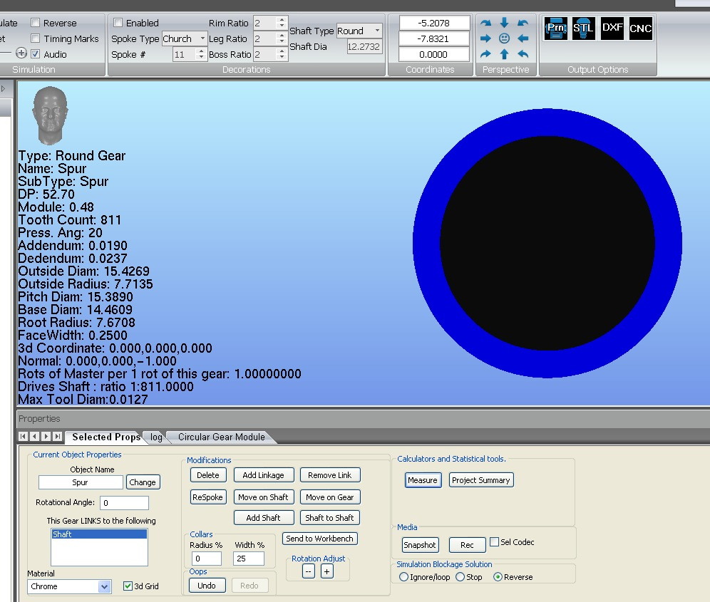

I am trying to make a ring that is 15.5 inches in diameter and has an inner diameter of 12.43 inches.
I've constructed a gear in GT that is the right outside diameter, I put it on the Project and strip the teeth. The info on the side says its 15.5 inches but when I cut it I get a 15 inch outside diameter. In order to get a finished outside diameter I have to "guess" at what the stripping will remove as there is no way to tell.
A second issue I have is on the inner annulus of the ring. I would like it to be 12.4 inches but the program won't allow anything larger than 11.3.

I never really planned on a planetary being stripped.. since the teeth arent on the outside
it will screw up. Stripping makes the circle to the pitch diameter which makes the two rings
intersect. You may have to wait for the cad module to do that one... Unless you make a normal
gear with a pitch diameter of 15.5 inches.. set the shaft diameter to 12.43 inches and THEN
strip the teeth.. that'd probably work..

There is still some sort of limitation on the shaft size - it appears to be limited to 12.27 where I would like 12.43 for my project.
I've used a spur gear with 800 teeth, because when I strip the teeth they are so small that I don't notice the change in diameter.
I can live with what I've got but thought you might like to know the shaft diameter limitation on the spur.

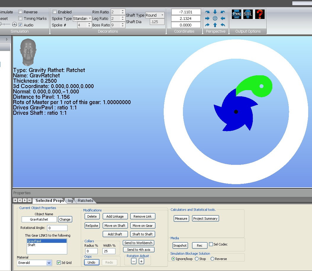

I would like to be able to create and "array" of pawls around the ratchet. When I add either a ratchet or the "pinion" I get both the pawl and the ratchet added at the same time (either by clicking ratchet or clicking "pinion"). I would like to be able to put 5 pawls around the ratchet. It is possible = sort of but I end up with 5 ratchets as well as the 5 pawls I want.

I see I misunderstood. You can already machine multiple pawls.. you just cant have them on the project screen working..
Ill add this to my list for adding more around the ratchet.. but Im thinkin when I get to a cad module it may solve that itself..
