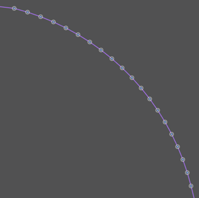

Re: import into fusion360
Art it's the way fusion deals with .dxf, it a silly way.
what happens is every sort line, line, arc or circle has a point at each end and a constraint at each end. if the circle has 100 sort lines it will have 200 points and 200 constraints.
so a gear may have 5000 sort lines so 10000 points 10000 constraints the bigger it get it will kill fusion.
it's not gearotic at all doing it, it's fusion it happens with all .dxf's.
I will pop a vid in here.

the pick is a corner of a tooth imported as a .dxf into fusion what is Viljo gearotic .dxf you can see how many points there are you double the count of points and add the lines the count of objects gets in the 0000 very fast.
