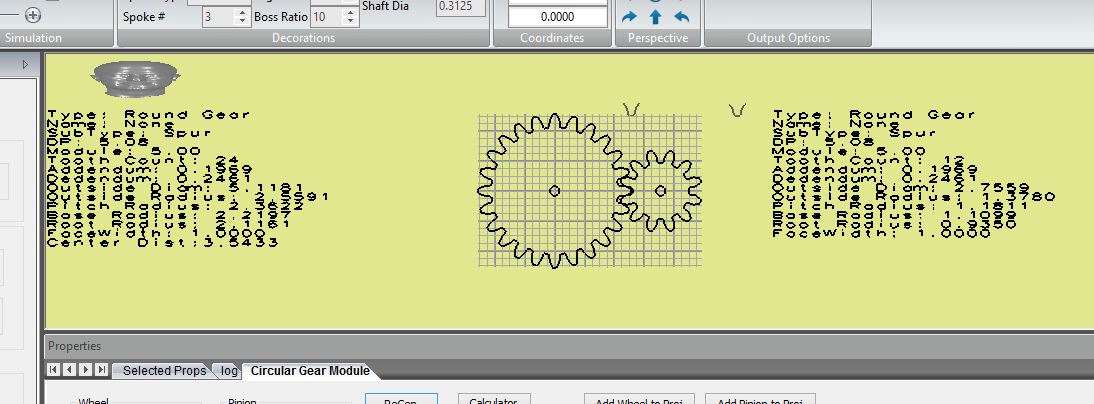

Hi Art:
Concerning the text on the screen. You mention you have several screens you use. Just wondering if you are seeing the same thing I am. Below is what I see (I hope). This is what I mean by hard to read. Hopefully it shows up below. It might be an attachment.

Dave:
I see what you mean, mine is quite a bit easier to read than that. Im investigating better ways and its all in once code
module that does all screen text ( unlike GM ) so its something that I can change over time as I develop better ways to
doing OpenGL text.. ( which is a bit of a pain in any event..)
