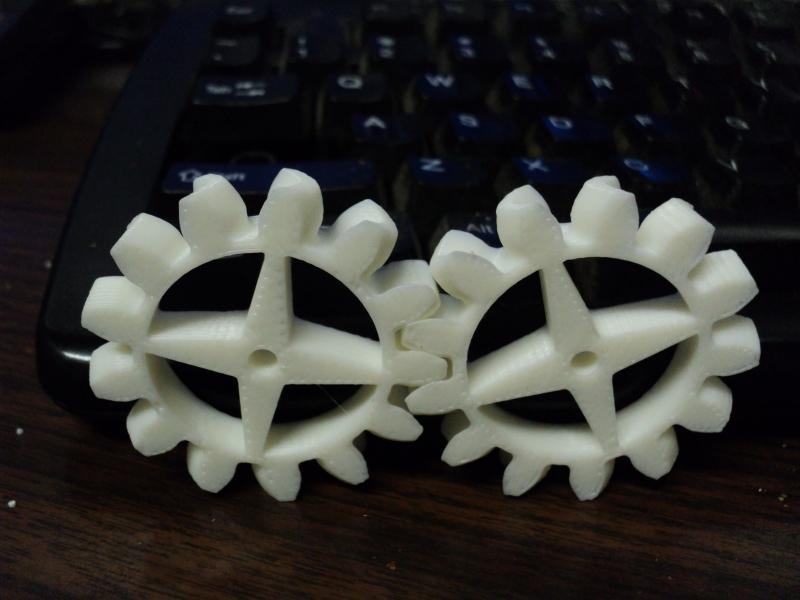

Ive so far printed spur gears, involutes, helicals and bevels in Nylon and ABS. These are as good
as any wooden gears Ive made, and are as accurate as Id expect from CNC'ing them from metal. They mesh smoothly and are incredibly detailed. In fact the involutes are the best Ive ever made because the printers resolution seems to as good or better than most cnc'ed gears. Admittedly you wouldnt want to
drive anything heavy, but the nylon helical is as capable as any Ive used in industry in things like Kodak XRay developers and such. If your into kinematics primarily, Id have to say the right 3d printer woudl amaze you with what it can presently do...

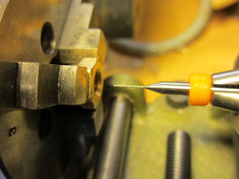

I've made nozzles as small as 0.2mm, and others are down to 0.1mm. The hot end on my Printrbot uses a 1/4-20 external thread so brass acorn nuts are a good starting point.ArtF wrote: But, it appears to me those problems are primarily of extruder size,
which is now down to .3mm or so..
It's been good for carbide drill bit sales, broke several in my 0.2 to 0.5 set. Fortunately it had two of each size, still have one of each remaining.

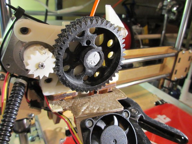

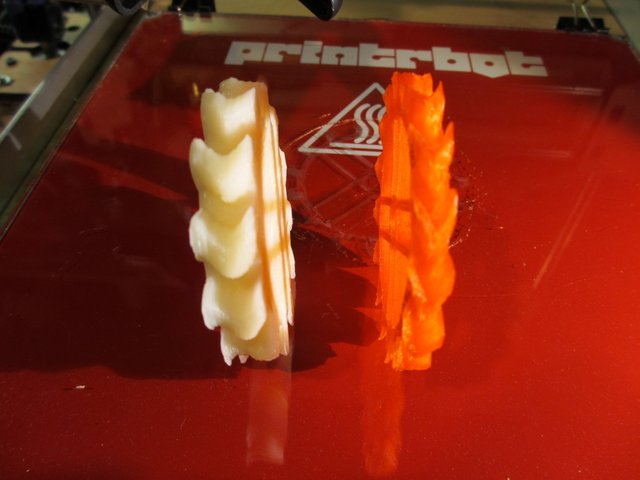

Right after I got my Printrbot I printed a knuckle gear after fixing the .stl file. Tonight I took the same project file and tried it with GT, and came up with some questions.
GT made the gear with triangle spokes, and a thinner spokes and rim than I would have liked. Is there a way to vary the spoke parameters and type of spokes? Tried changing them in GM and resaving, but it didn't seem to make a difference.
I had to rescale the stl file from inch to metric (or print a very tiny gear). When I did the printed gear diameter was the same (very slight variation, but I've gotten much better at calibration). However, the gear thickness was 2/3 of the one I printed back last August. Not sure what this means; my Z calibration hasn't changed since it's allthread and I used the calculated steps/mm all along.
The original stl file crashed slic3r 0.9.9, both unscaled and scaled in slic3r. Netfabb said it was fine. I used meshlab to scale and remesh it, went from 294284 to 147140 faces, this one sliced OK and is the one I printed.
The first time I exported the stl I did it across the network to the notebook connected to the printer, and it took about half an hour. When exported to the local hard drive it took well under a minute, and only a few seconds to copy with windows explorer.
Not GT's problem, but the teeth look more arrow shaped than I'd like. It's probably a no support/overhang/cooling issue.
Don't laugh too loud; here's the pix. The white gear is the one from last year, the red one's tonights, the lighting's not very good so I hope they turn out. It's printed with 0.10mm layers, 0.3mm homemade nozzle, and in PLA.
The black gear is one that shipped with my printer. I'm waiting until GT can make one with a hex insert and maybe reduced center. Don't care about the herringbone...

Hi Kirk:
The Helicals, ( knuckles are a type of helical ) never had spokes, BUT the information
of the spokes selected was stored in the data. GT isnt really loading the project the same way
GM does. GT, once it loads a GM project basically has an outside contour and spoke information as well as thickness and such, from there it does a re-extrusion based on its
own code, not the extrusion library I used to use.
Because of this some things will vary, ( though thickness isnt one of them , they should be the proper size. The next version of GM will allow you to turn those spokes off or on, or change the shaft size and such in real time on the screen as a 3d object. I had to do it in this order so that extrusions and such work, then Ill be adding the code to actually recreate
the gears including spoking and such.
STL's have no setting of mm or inch, they are in the native units used when GM created the gear. A gear of 1" or 1mm is the same STL in size. This is another thing that will take care of itself when GT gets a bit further along and can do creation as well as extrusion.
Ill run some tests here on thickness and such, and Ill print a knuckle so
we can compare. Ill let you know what that looks like on mine.
I wasnt aware that people were making .1mm nozzles, thats interesting...
sounds rough, I can understand why so many broke bits. :)

Just printed a couple of knuckles here. They mesh very well together, as if their a locked set you cannot pull them apart side to side, its an interestig type of gear really..quite unique. Didnt find any trouble doing them and they look pretty symetrical.
HErringbone you should be able to do by end of week if I can finish a few items this week.

If you even accidentally brush against a 0.2mm bit it'll snap, and maybe even heavy breathing will break one. I'm probably not up to anything smaller, yet.

Welcome to the dark side..personally, I think once you get used to metric you never go back.
By the way, take note that a knuckle angle should be around 15 degrees, more than that and youll get very thin and sharp teeth.. other than that they seem a great type of gear for extruders..
