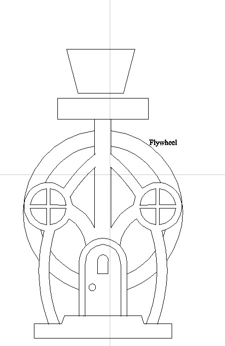

So far Ive only drawn a rough diagram for myself, but Im planning a floor standing frame with a 16" or so wheel
on a chrono with a sprung clock spring as my hairspring.. Maybe 30" tall or so in total. I figure most wives who
wont hang a wall ticker would probably allow a standing plant stand that slowly ticks and rotates the plant.
, so its a viable project and allows for some artistic creativity.

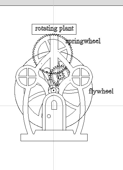

I only began the thought process a week ago, but heres a rough sketch of my thoughts on a
"Gearotic Plantstand for the Wife". First sketch, just a thought really..
(Added snapshot showing gears on chrono escapement)
