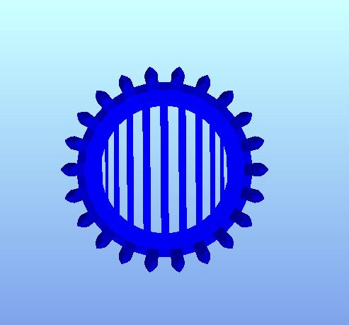

Re: Failure in STL Output
Tried both inch and mm with the same result.
The gear which is generated shows the errors (the stripped bits) I took a snap shot to show you, but that only shows a blank page?
So I have took a snip to show you.
Regards
Regards
Ahh, I see. The epicycloidal teeth probably do that. They dont follow the same ruiles as the involutes and can generate bad caps..
Ill add this to my list. Do you find involutes have the same trouble?
No the involutes are working fine, I shall use them instead as it wont really matter to the project as I am only proving the concept at this stage. I think for this particular gearing it will have to be crown gears which you are not able to offer at the mo.
