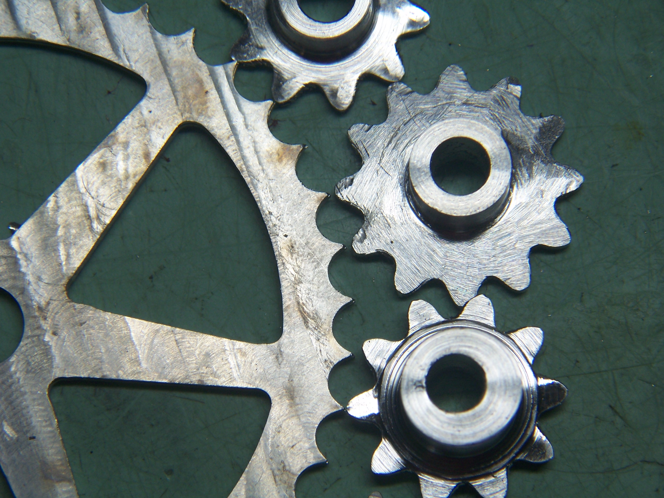

This photo shows the difference between the two types of teeth that I've been generating. Both were DFX exported to BobCAD/CAM. Generally only did rough profiling on the larger gear with 3/16" end mill. I would think that doing a final profile with a smaller diameter end mill might change the profile of the tooth. I also had to "reverse the start point", otherwise the cutter tried to work within the part and not the waste area. BobCAD doesn't seem to think this is an issue. Changing the tool offset doesn't seem to work.
Re: collars
Well those small ones look odd..but the large one just looks...wrong..
Does the DXF show those sharp points? I cant find a type or size that makes that...
It looks very much like the tool size was off or something.. At a minimum the large one should match its dxf exactly.. Were these cut 2.5D?

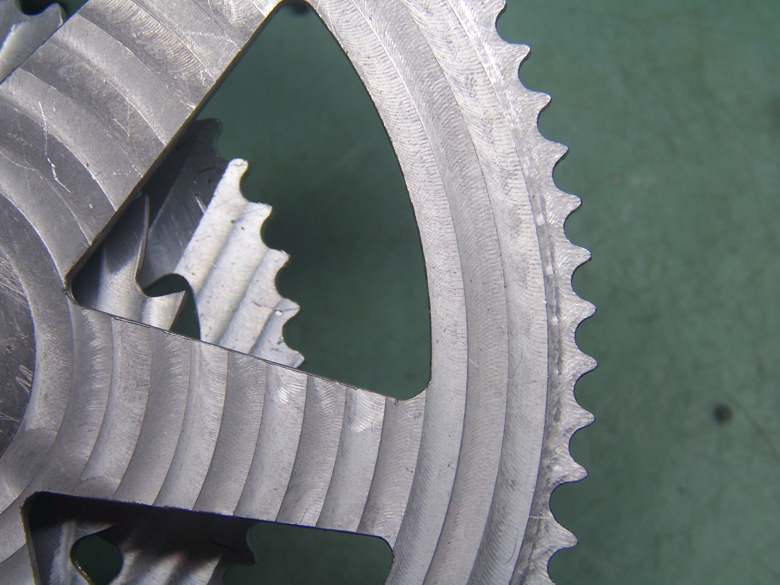

I didn't like that one either. Here's the profile I'm probably OK with. Its my 7 inch sprocket and the weight chain sprocket. Wrapping the chain around these seems to tell me they're ok.
Re: collars
Yes, those look much better. In the end the best test is as you noted if the chain fits them, if it rides well the sprocket is fine generally..

Ran the sprockets with collars per my prior posts. I'm going to forget using BobCAD/CAM to do the machining - the reason? - your cnc works MUCH BETTER. Nice teeth, no drama (except for having to put in M3 and M5), and instead of one or two teeth engaging the chain, I can wrap the chain around the sprocket engaging a typical 4 teeth. Drill and thread for a 4-40 set screw and they should be ready for testing.
Notes: It seems that a sprocket with less than 10 teeth needs a relief cut on the collar to allow the chain to fully engage, otherwise the inside portion of the chain can't seat. Some filing is required to sharpen the tooth, but basically just clean up the milling marks.
