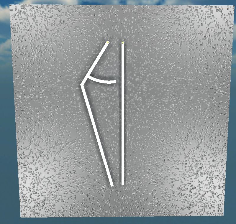

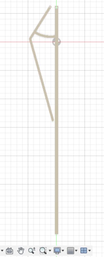

Is there an X-Y size limit when creating assets from STLs in particular from Fusion 360? I created two objects in Fusion 360, exported them as STLs and then created assets in Ticker. I then imported the created objects into Ticker.
Attached are jpgs of Objects created in Fusion and the same objects imported to Ticker as an asset. Note that the bar has been greatly shortened.
I can look at the STLs with Vexx and the raw sizes are correct. The bar length should be 400mm.
