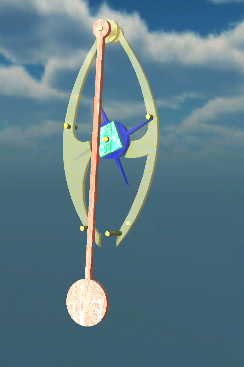

Re: A gravity escapement
Bill:
Just running testing to see if I can make a grav escapement with B2.0 . I cannot yet tune it to run more than 2
or 3 ticks.. but on the bright side it took less than an hour to make this example..
