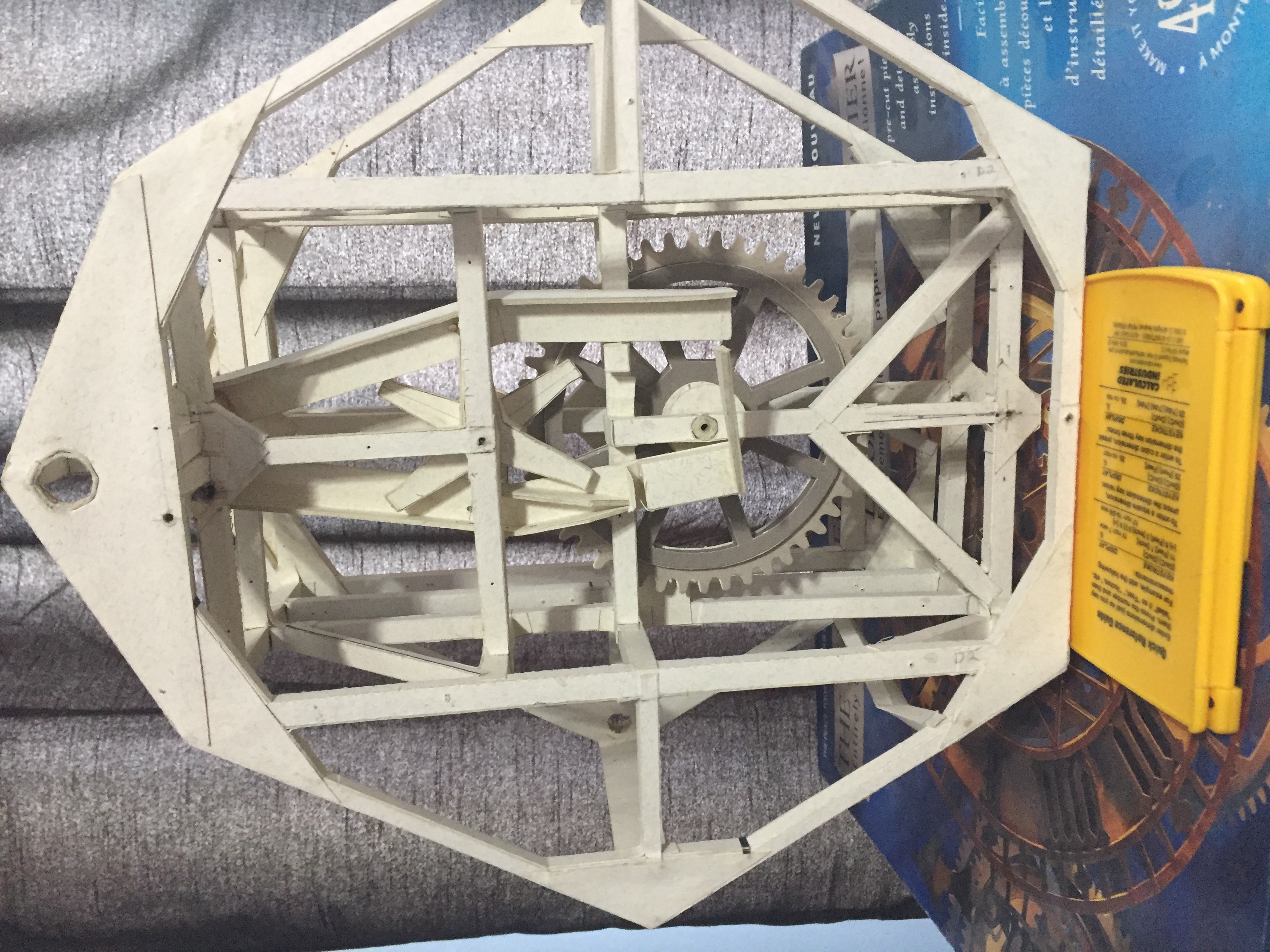

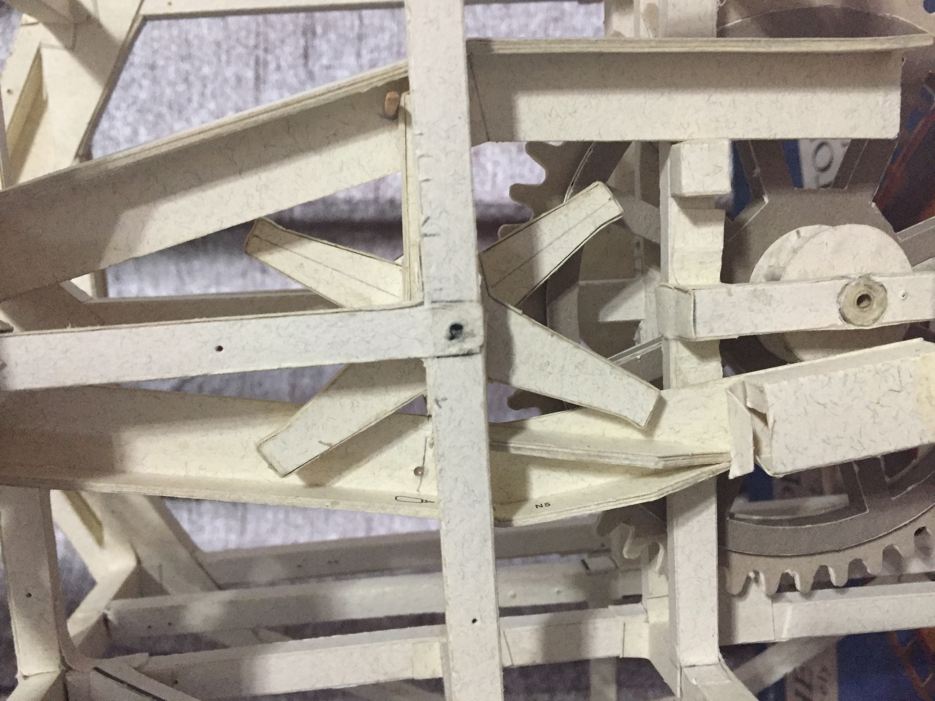

I was going through the forum this morning and came across your post and remembered that many,many years ago I build a clock made completely out of paper. It uses, I believe, is the same escapement as you are describing. It doesn't use a spring but rather a small paper box that I filled with sand (as a weight) . when the pendulum pushed the left arm out and released one leg of the (Star wheel) I believe that's the term the instructions used to described the escapement wheel) the weighted side would return the leg.
My intentions where to dig the paper clock out of the catacombs and duplicate it using wood and recreating it using Gearotic Motions. (that hasn't happened yet, LOL) I thought this would be of interest to you.

Jerry
Thanks for sharing the info about the paper clock. The escapement that the paper clock uses is similar to the model that I created using Augie's vector processor. I don't know if you had a chance to download and run the model...it does not use any springs. The model is being designed based upon a GIF simulation that I found on the internet.
I think you should dig into the catacombs and recover your paper clock. You have an ideal situation where you have the actual gears of a running clock that can be modeled using Gearotic Motions. I think such an effort to learn Gearotics will be worth the effort. A while ago I used Gearotics to model/document the entire main train of a tower clock that I have access to.
The particular gravity escapement is not modeled in Gearotics but you do have the original that you can measure and make wood equivalents.
Modeling the escapement using the vector processor is a challenge. Getting the timing correct between the vanes that lock the arm relative to the pins that lift the arms is a problem that I'm currently working on.
Thanks again for sharing your photos.

Bill,
Thanks for the words of encouragement. I admit the project is long over due.
I reviewed your model in augie and it looks great. I'm no where close to having the skills or abilities of designing a project by scratch.
My intention was to take the plans from the paper clock and scan them into a dxf format then import them into CamBam software to produce the framing
then use gearotic to produce G-code for the gears since I have the gear info at hand.
Let me know how your model is coming. I always appreciate someone that can take a thought or idea and turn it into a working model
