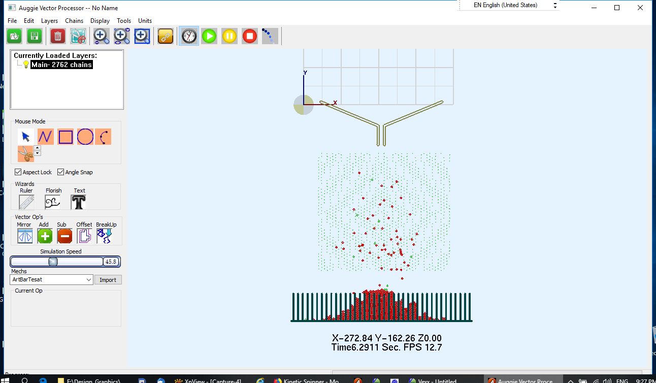

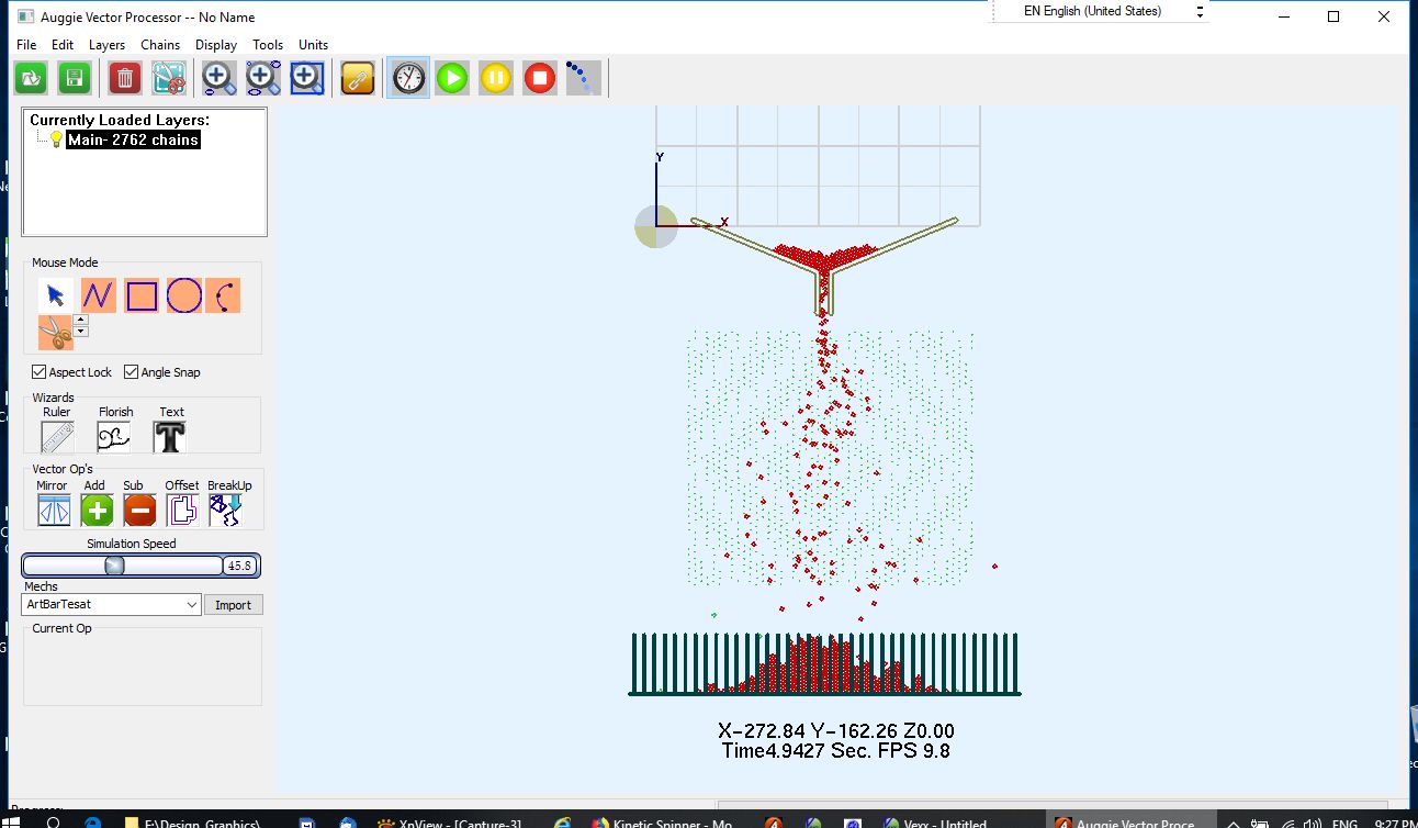

I've decided to learn more about the Kinematic capabilities of the Augie Vector processor. Over the last few days I viewed some of you videos regarding the processor and duplicated some of your examples.
I always like to stress the limits of programs so I built a simulation to demonstrate the binomial distribution. The inspiration for this model was a box that I had built decades ago when my kids were in 4th or 5th grade. The box contained BB's, a bed of nails, and catch bins that demonstrated the effect of a sequence of binary events that over time form the bell shaped binomial distribution.
The first two attachments are jpg's of the simulation near the end of the run. The attached .vcp file contains the simulation and I also encapsulated the whole mess in a .mech file. It took eight tries to tweak the model to get a reasonable approximation to the distribution.
The simulation starts out with 800 small balls that fall onto a funnel object. The funnel is an attempt to create a single stream of balls to drop into the grid of pins. I lost count of the number of pins.
I run the simulation ~40% rather than 100%. I do see some anomalies at higher speeds where some of the balls drop through the catch bins at the bottom of the model. Perhaps these anomalies are caused by the decimation of some of the objecs and the sheer number of collisions the program has to calculate.
I don't think I'll do much more with this model. The comb structure of the catch bins should be taller. The sides of the funnel should be longer since some of the balls spill over the edges.

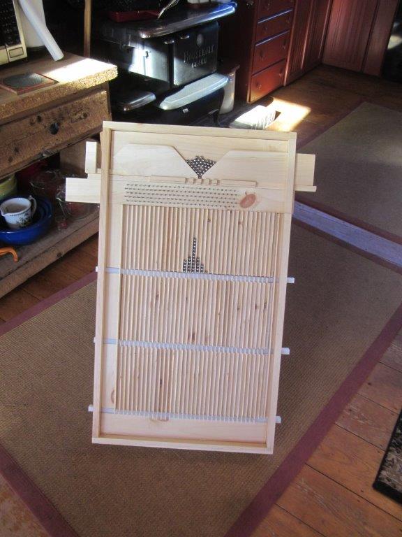

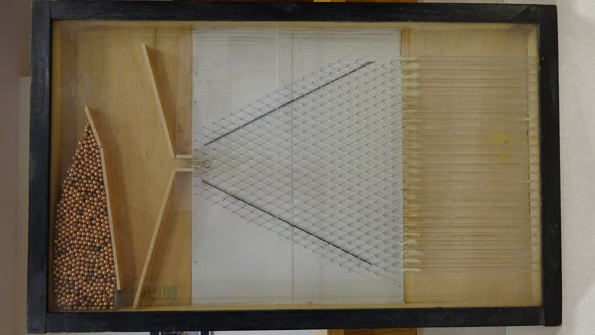

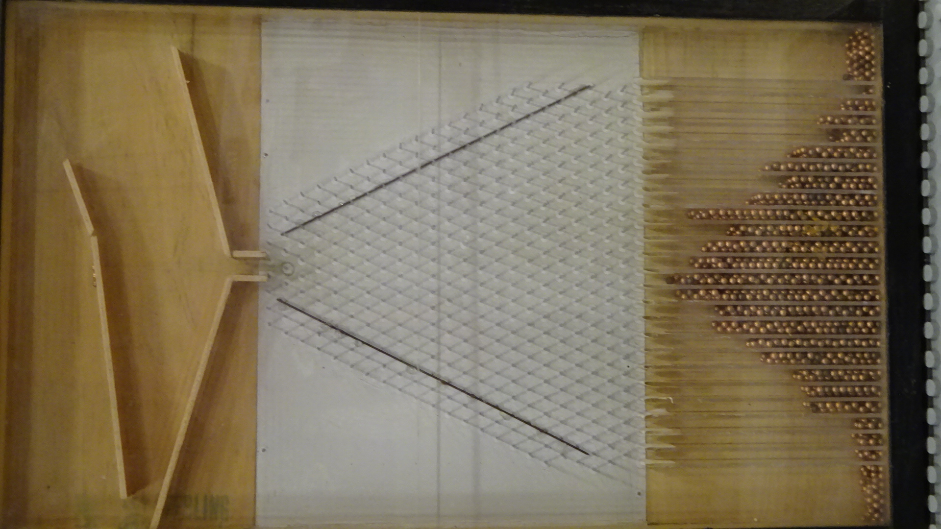

I liked BMeyer's note about the Galton Box/quincunx that he built. I was unfamiliar with that particular box. My inspiration for the box I built was a large scale device at a Science Museum that demonstrated the principle.
Out of curiosity I dug around in our closets and attic and discovered that I still had the device that I built decades ago. The attached two jpgs show the device in its initial and final states. The zip file contains an MP4 movie shows the device in action. I edited the file to show the first few seconds and last few seconds of the device in order to shrink the size of the file. Note the shape of the final distribution compared to the Vector Processor model is quite similar...not that I am surprised.
It took a while for me to get used to operating my device. The firse time I released the BB's too quickly and they jammed at the mouth of the funnel. The Vector Processor model of the device had similar problems (just goes to show that the physics of Art's program really work). Notice that the balls in the model are spaced into groups to slow down the volume of balls hitting the funnel.
